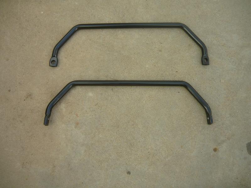

I've had my sway bar bender take a look at the bars of this car and make some recommendations. Since the front bar is already 1", and the way it is installed in the car, there probably isn't much to do there. However, on the rear, he thought upgrading the size from the stock 11/16" to perhaps a 7/8" diameter could make things more interesting. Anyway, I had him make up a couple, and here is what he did.
Upgrade bar #1 is basically a direct copy of the stock bar, with only and increase in diameter. It would mount to the car using new brackets and poly bushings, and then the stock end links.
Upgrade bar #2 is also a very similar unit to stock (again 7/8" diameter), but instead uses more traditional end links which may be helpful in adding preload in one direction or the other.
Below is a pic of the 2 units.

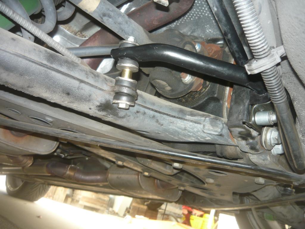

Hello all- boy how time flies. I just realized it's now early May and the last we talked about the new XK8 rear sway bar was the end of Feb. Sorry for the delay- just as we were getting ready to get one of the new bars on the car, the trans cooler failed in the radiator. Luckily, it was the radiator that filled with trans fluid and not the other way around. A messy cleanup, but not a disaster.
We've had one of the upgrade bars on the XK8 test car now for a few weeks and so far so good. This particular bar was the unit that used traditional style end links rather than the factory style. That keeps overall costs low and they are very simple.
Attached are a few pics of the bar installed, with clear views of the end links on either side. Note- the production bars will have slightly altered end lug angles to better correspond to the lug on each trailing arm. Also, the end link hardware will be more finalized- these are really just quick and dirty parts for testing....
