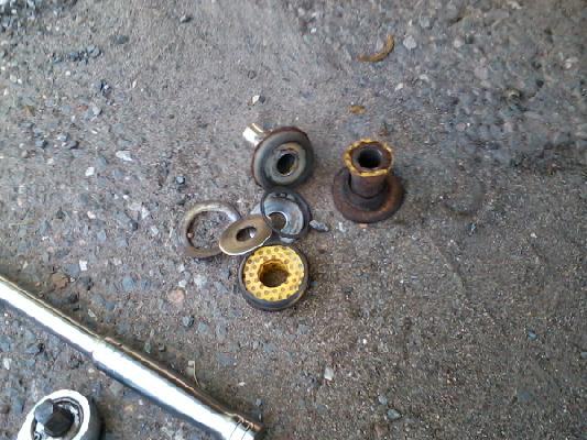

Okay, so I finally got fed up with the driver side and moved on to the passenger side... and it came out with no (and I repeat, NO) problem whatsoever. The bushings were absolutely demolished.
The driver side I still cannot budge. I had a great idea to modify a bit on my air hammer and go at it - nothing still. When I try to crank the bolt, I can see the aluminum subframe bending. This is not good. I noticed a few weeks ago that someone removed the front x-brace. Does this brace add support to the subframe? Maybe I am torquing the subframe because the brace is missing...
So I put it back together and I am going to drive around on it and see if that loosens it up. I hit it with PB blaster about 20 times over the course of 2 days, so maybe between that and jostling it by driving it may come loose.
HOWEVER, even if I get the bolt out, I noticed that all of the shims are gone. The passenger side had a large shim on each of the ends, plus two smaller shims on the one side. Anyone know where I can get these shims? From what I can tell, the little ones go in various places to adjust the alignment as well. So I guess I don't even know where they are supposed to go.
Hi Marty,
The shims are used to adjust the castor angle for each front wheel. There should be a total of two thick and two thin shims on each side, but they may be in any order and should be replaced exactly as removed. I'd take a close look as the shims may still be in place on the 'awkward' side. All is not lost if you can't find them, as there is a default arrangement that will be fine until you can get the alignment done. For LHD cars, the setting is:
LHS/driver's side - front: 2 thick and 1 thin. Rear: 1 thin
RHS/passenger side - front: 1 thin. Rear: 2 thick and 1 thin
The difference across the axle is to allow for road camber, I understand. This default setting is swapped across the axle for RHD vehicles.
Jaguar part numbers for the shims are:
MJA 1467AA (Thick shim)
MJA 1467BA (Thin shim)
They look like large washers, except they're colour-coded (one is blue and the other red - can't remember which is which) and they are also around $4 each! I understand that the fulcrum bolt is about $50. Boy, for a set bolt and washers that is going some... I'm definitely in the wrong business
When I finally got around to fitting the upper bushes on mine this year (looked at the invoice and I'd bought them in 2005) it was very straightforward, but we don't have salted roads here. Other have said that getting the shims in place was difficult, but I didn't have any issues sliding them in place while pushing the pin through, although I did use OEM bushings. On the basis that it's likely to be me doing the job again next time, I used lots of the bomb-proof blue marine grease on both the bushes and the bolt to make sure there won't be any future seizures. May be something to add the the two year service - knock out the pins, regrease and refit...
Good luck, I'm sure that the stuck bolt will eventually surrender. Given the dissimilar metals I would expect heat in moderation will be your friend in conjunction with you favourite big hammer. Hopefully you won't have to resort, as others have, to breaking the wishbone and cutting the head off the bolt.
Another bit of poor design IMHO. Jaguar could have split the upper wishbone in a similar manner to the lower. Wouldn't have added much unsprung weight or cost
I've no doubt that a car designed by me would be nice and easy to maintain: just unaffordable...
M

Hmm. I may be missing shims on the "good side" as well. I only found 2 shims on the good side. There were also 4 washers that (let me see if I can describe this without taking the car apart agian) protrude inward toward the center, I guess, to make contact with the metal of the bushings while not crushing the rubber around it. From what you describe, these are not shims, but they also did not come with the new bushings. These are definitely missing on the "bad side". I haven't gotten it apart yet, but I can tell the bolt and nut are right up against the metal of the bushings themselves. Are these things additional, or are they replacements for the shims?

So I'm trying to figure out now exactly how many of each spacer I am missing, and from all of the help on this thread I have determined that there are four per side, two thin and two thick. I see the parts on SNG Barratt, so I should be able to get them.
I just want to verify that these spacers are NOT the stepped type washer I mentioned in my previous post. Sam mentions these "cone shaped" washers, as he puts it, at the 1:40 mark of his video: www.youtube.com/watch?v=wBHALcuwi3Y . But he only mentions them once, and I only see them on the outsides of the control arm. I have four on the "good side" and none on the "bad side". How many are supposed to be on each side, and does anyone have a part number for them?
See attached for a photo of my setup, I'm working on this today so it was a good time to get this for you. This is my right side, as you can see I have one thick washer [blue] on the rear, one thick [blue] and two thin [red] on the front. On the left side I had one thin washer on the rear and two thick, one thin on the front. The "cone" shaped washers go on each side of the bushings as you suggested with the "cone" part against the bushing washers. The shims go between the "cone" shaped washers and the frame on each side.
After I get everything back together I'll take the car to an alinement shop to check and adjust as needed.
Hope this helps and good luck.
Wow the bushing in your picture looks well mashed
The four washers you describe are indeed 'cup shaped', and sit immediately against each bushing face with the centre depression facing the bush. There are, therefore, four of them on each axle and they are in addition to the shims. The EPG describes them simply as 'washers', and gives a part number CAC3533. You are correct that they do NOT come with the bushings.
Be guided by the pics and video as these give an excellent indication of what and how everything fits together.
I used the blue marine grease on the rubber as well to ease assembly into the wishbone. JTIS suggests using 'a suitable lubricant', and this stuff doesn't attack rubber.
I only found three shims on one side when I did the job. I'm almost certain I didn't lose one when I was taking things apart (and that it was a first-time repair) and was going to rebuild as found but I didn't fancy the compression stress that would place on the wishbone, so I added a new shim to replace the 'missing' one.
