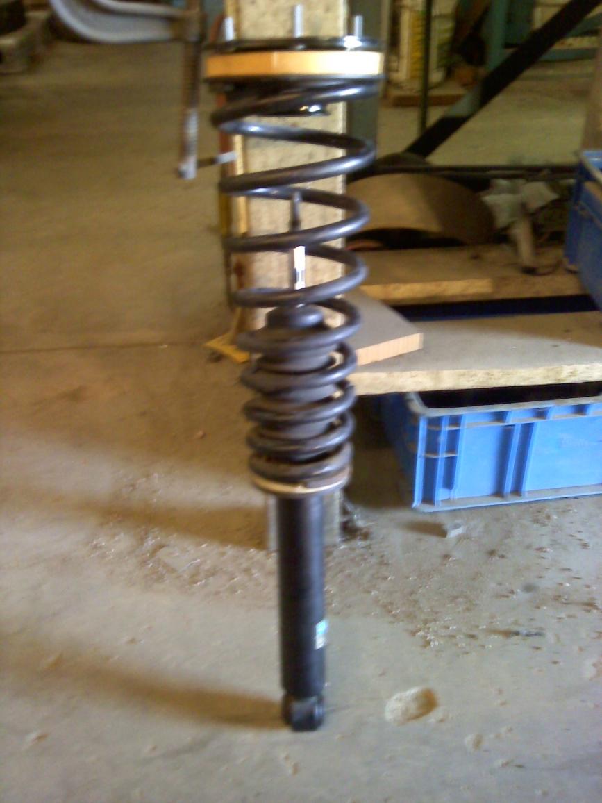

Part finally showed up so I replaced the top shock mount on the drivers side today. I check the dims tomorrow to see if it made a difference on that 1/4" I had.
Took some pics for you guys and I hope you can use them.

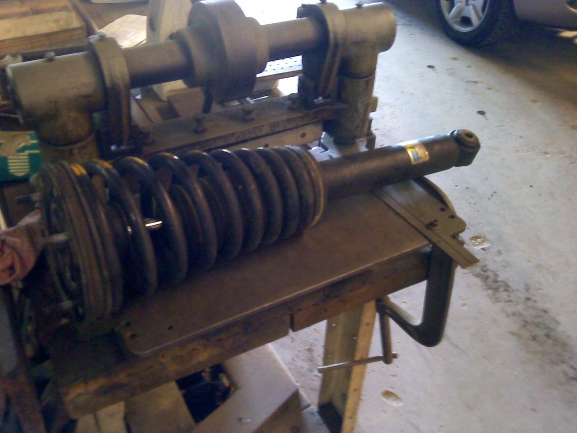

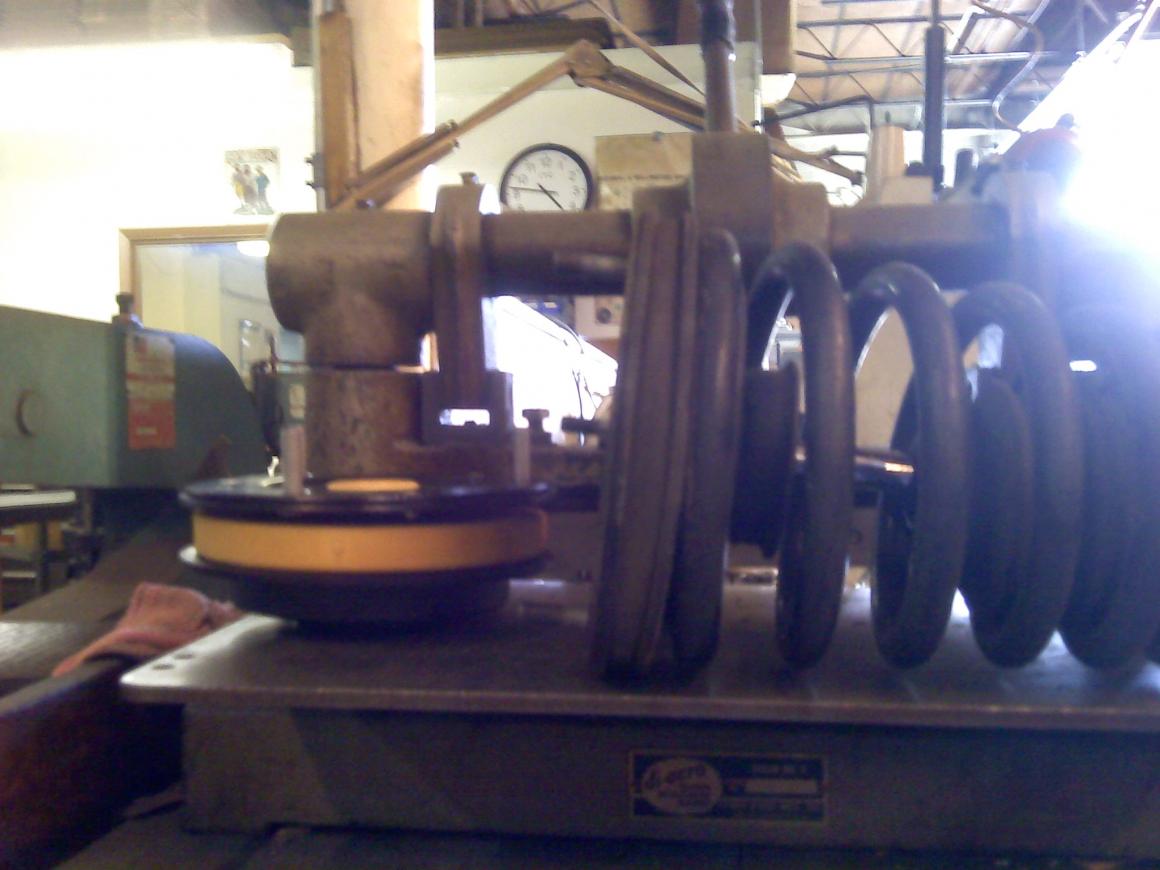

I Used 2 hydraulic jacks for the project along with a drill press at my shop for compressing the assembly. Do not attempt if you don't have away to compress the spring. You may be able to do it in the vehicle but I ask a tech about that.
Here's the steps I took

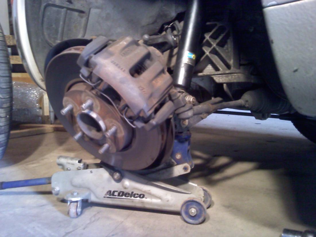

Step1: Jack and remove front tire.

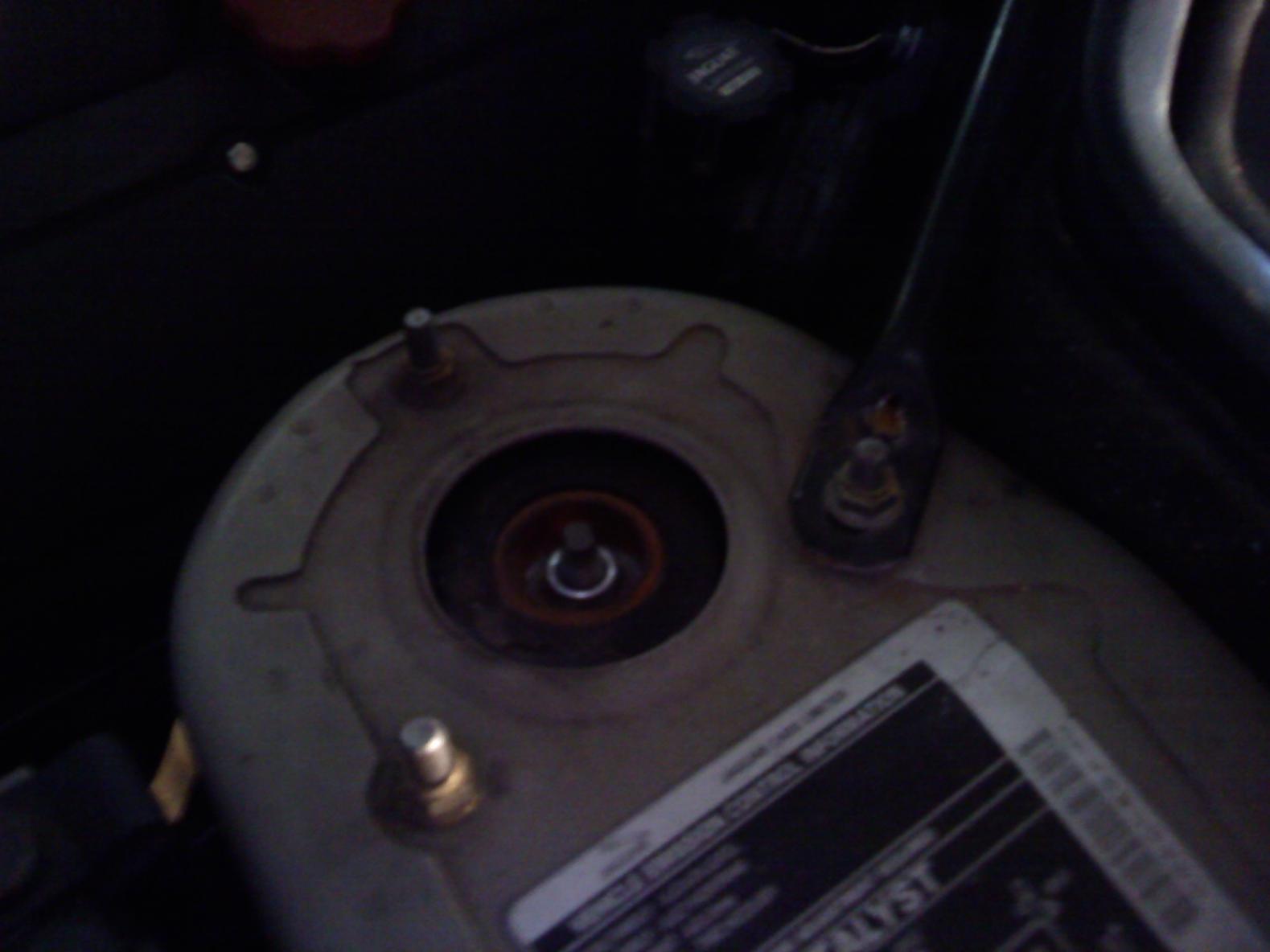

Step 2: Loosen top center shock bolt a few turns but do not remove. Loosen 3 upper shock mount bolts.

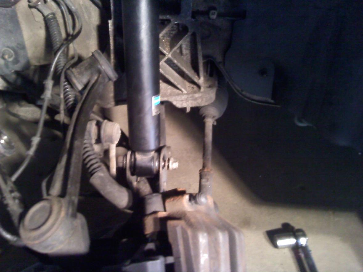

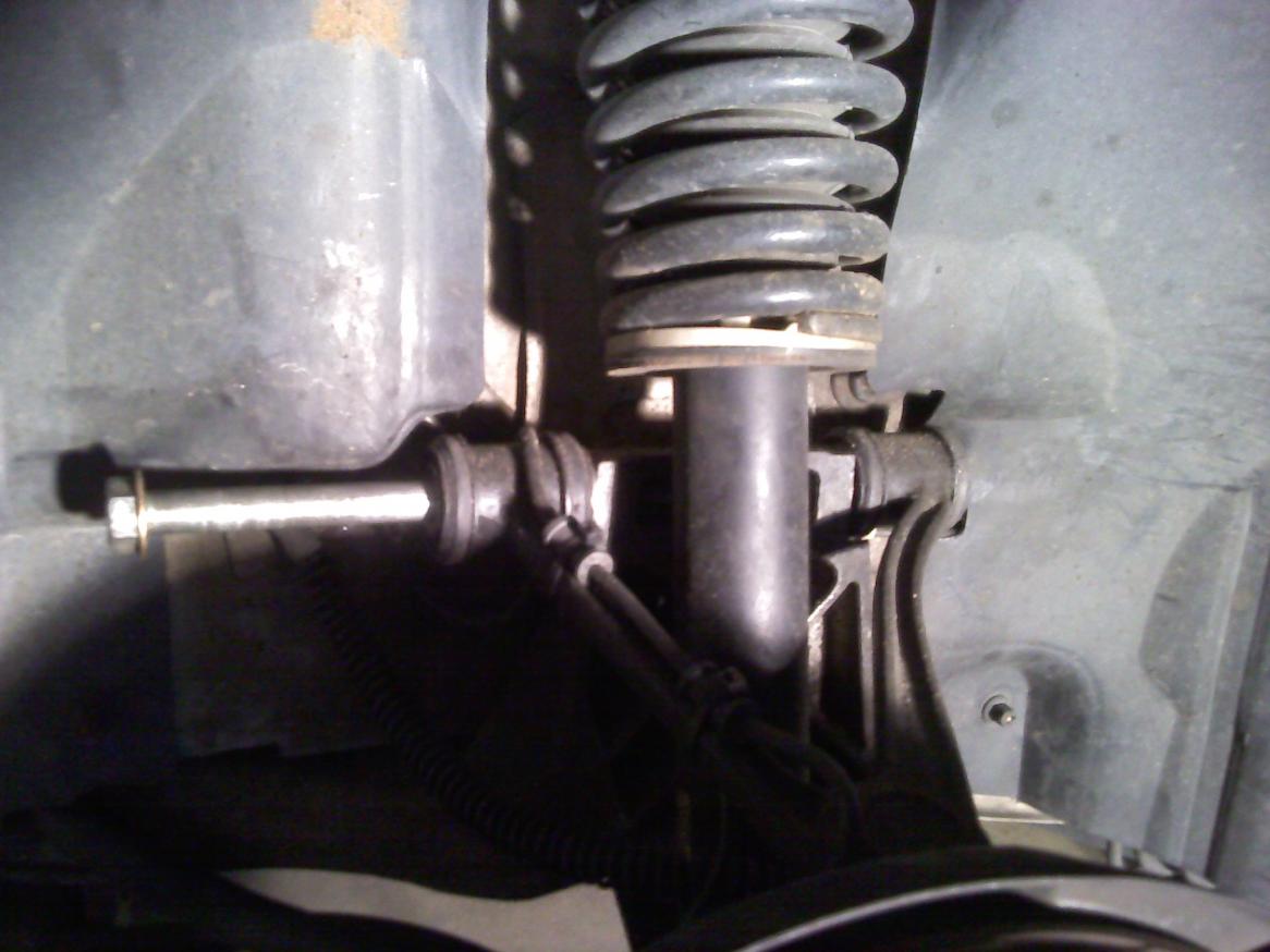

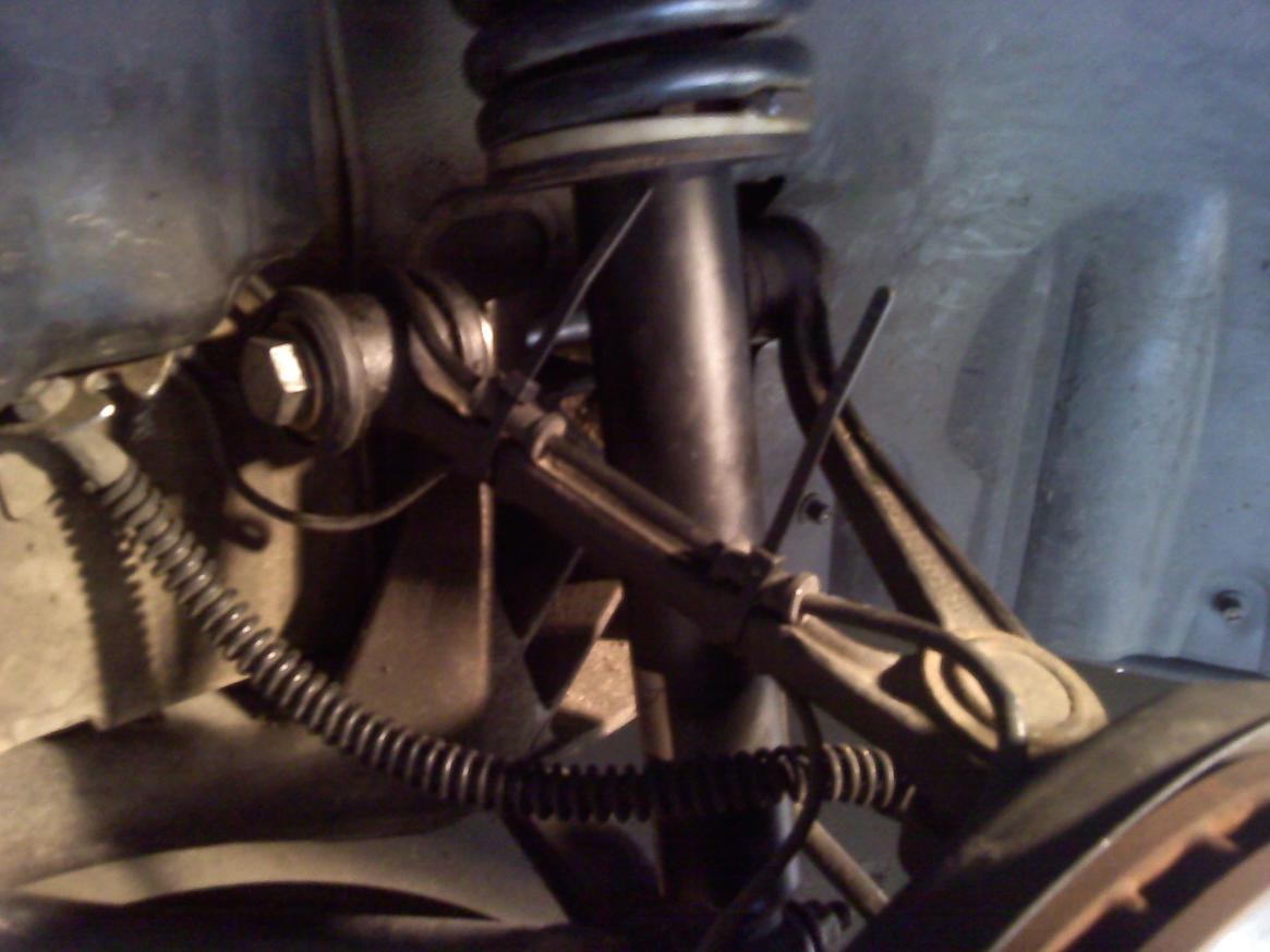

Step 3: Cut 2 Wire ties holding abs and ground wire to A-Arm. Remove A-Arm Bolt and move arm out of the way. A-Arm bolt should slide out easily. Note placement of shims on inner sides of A-Arm. There is a thick and thin shim on each side. By the way this also how you adjust camber for wheel alignment.
Step 4: Placed 2nd jack under lower arm and raise to apply tension to arm.
Step 5: Remove lower Shock bolt and Sway Bar Link Bolt. You can use jack to rasie or lower arm for easier removal of bolts because they kick a little while trying to remove them.
Step 6: Removed upper shock bolts and assembly will slide out of car.
Make note of relationship of upper shock mount position in relation to the bottom shock mount. Also the way the spring is positioned in the car.
Step 7: Placed in my drill press and raise base until assembly was held tight then removed top shock bolt and slowly released tension on spring.
Do not under any circustances remove top shock bolt without have assembly secured at both ends. Spring is about 6" taller when free and you could seriously injur yourself. Or at least have parts fly all over

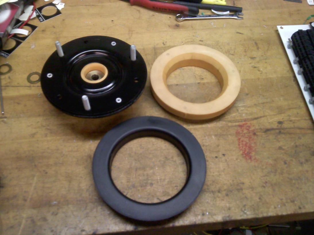

Step 8: Removed old top shock mount and replaced with new. Line up shock mount bolts with bottom of shock.
Step 9: Placed back in drill press, compressed assembly, and replaced top center shock bolt.
Step 10: Placed back in car and assembled. Make sure replace wire ties that hold ABS and Ground Cable after assembly.

Here are some pics of the new shock mount and one of car, sorry its not a great pic. They are fun, 130K on the engine and 170K on the rest. Apparently Engine Block was swapped after 40K because of the Nickasil. Hope I spelled that right.

How do you compress a spring with a drill press?
Very Carefully
The top stays in place and the lower table moves up the rack to compress (need a good sturdy press). I have it fixtured so it can't pop out and there's a hole in the table so I can remove/tighten the shock nut. I'm sure spring compression tools would work fine but I did'nt have any at the shop. I need to get or make some though because I have to do the rears and those have to be compressed before I remove them. Not the same setup as the front.

I would recommend removing the caliper form the knuckle as you were stressing your brake hose.
Thanks Silver, I noticed that the brake hose would get stressed.
