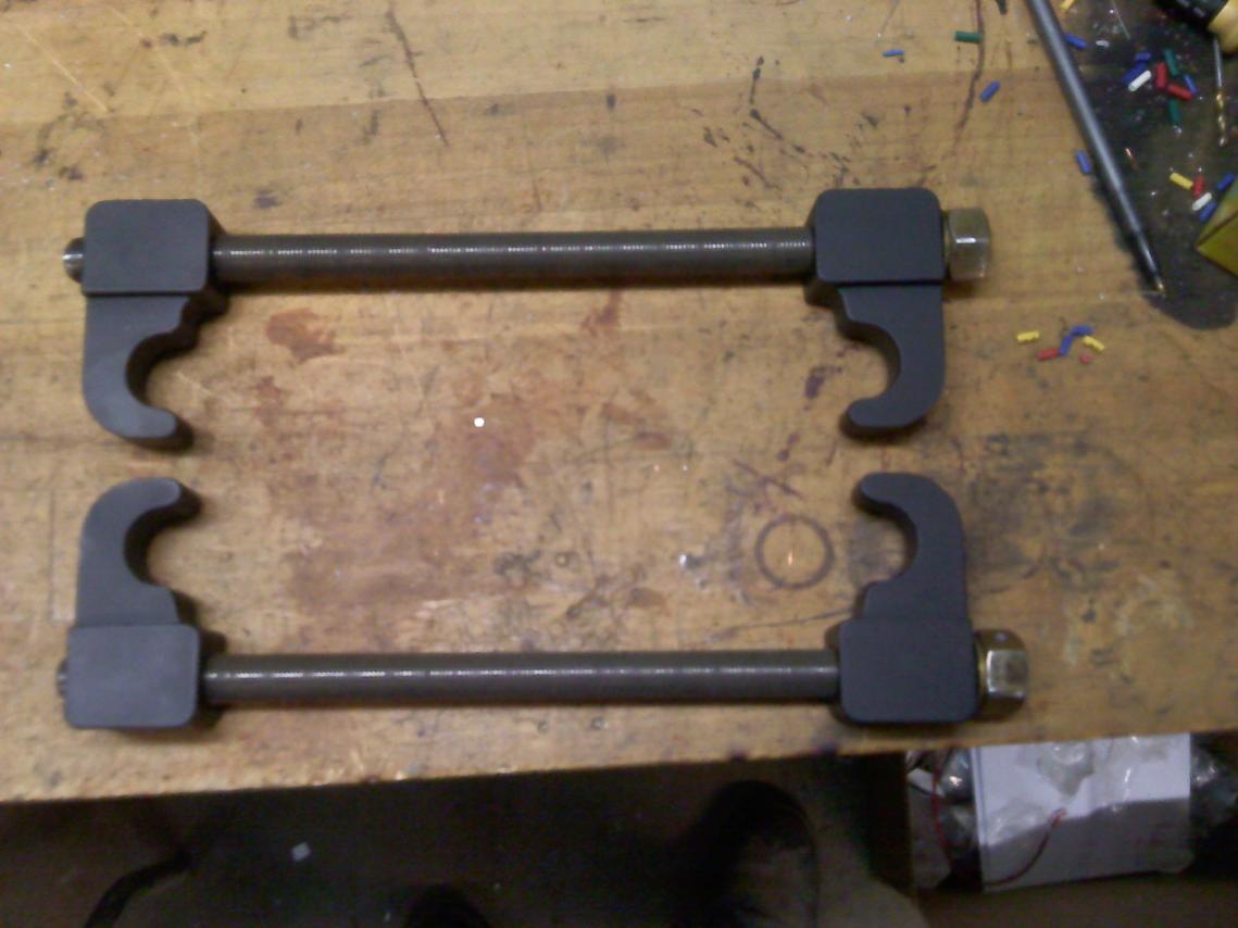

Your welcome squirrel, I'm still waiting for the passenger one to come in and my passenger side dash still has something living in it. I'll use the spring compression tools I made instead of the drill press this time and repost some pics. Much safer way to go and it won't even cost me any beer.

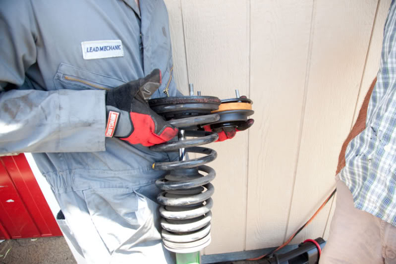

and for the record....here are a few shots of the new shock mount being disassembled, as well as the old one apart and the two next to each other. What a mess!

Excellent photos. Is that degree of deterioration typical for these upper mounts. If so, it would seem that a better material/formulation could be found for the polymer gasket. The photos suggest that the parent materials totally degrade. One has to wonder after all this time why this part has not been updated with currently available materials that are not attacked and broken down so extensively.
