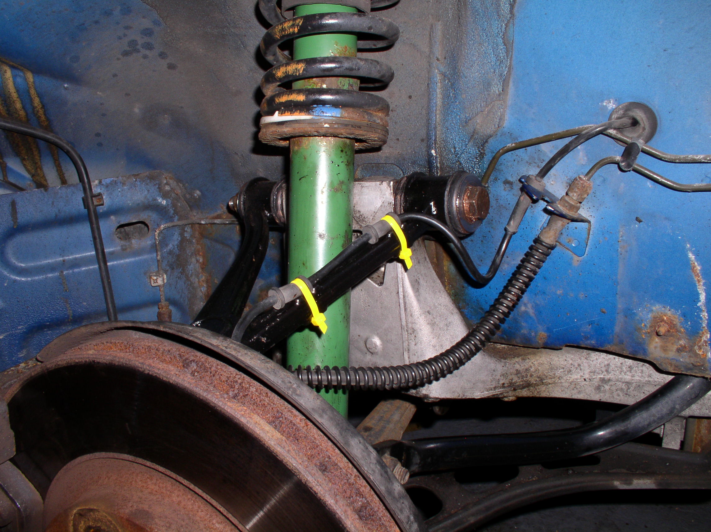

Yes take the liners out otherwise I don't think there is enough room to remove the bolt.
Old Jul 14, 2013 | 11:16 AM
+1
Remove the liner.
Compare the working space you are looking at with this:
