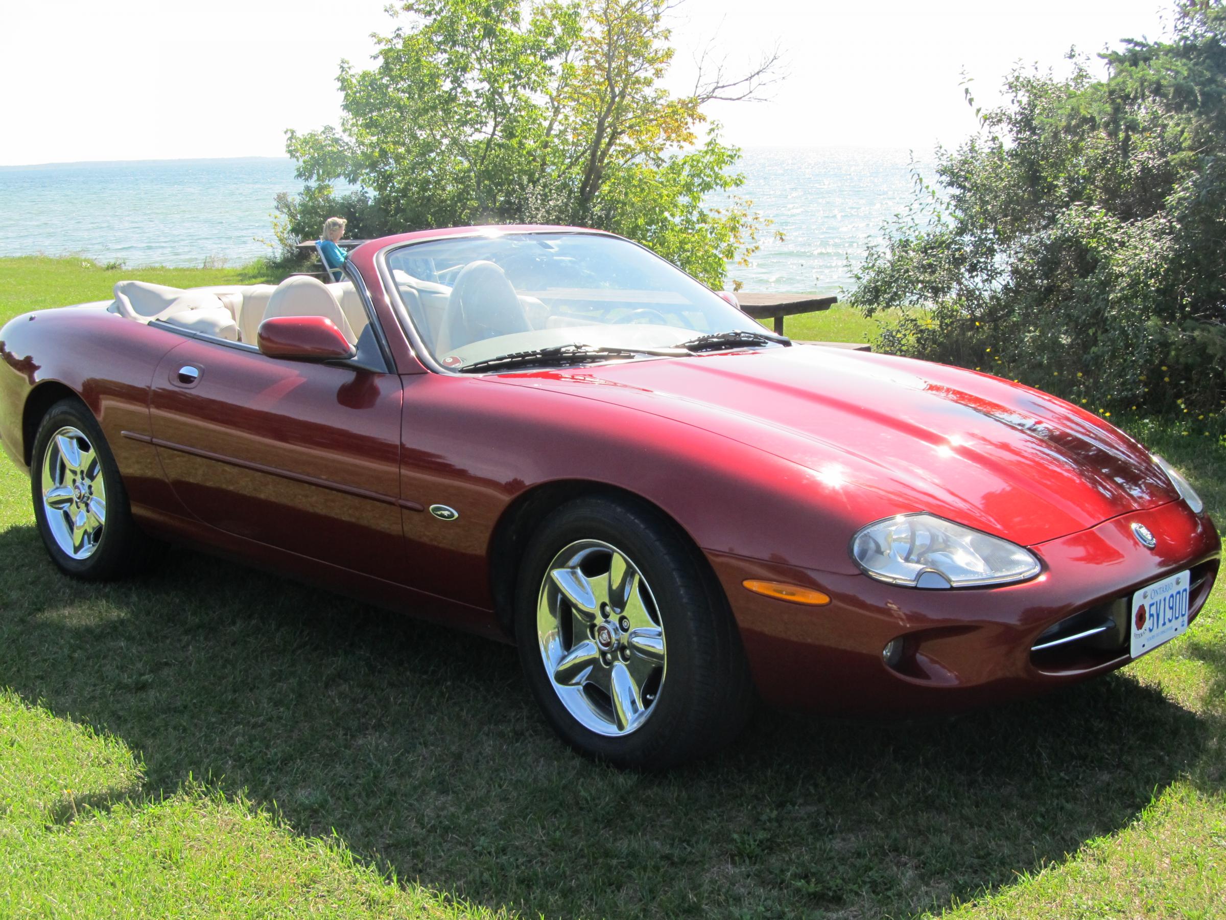

My 1993 Mazda MX5 Miata had a twenty year old radio/CD which did not work that well (CD did not work) so I replaced it with a cheap ($100.00) Sony radio/CD player which included a USB port. I ended up using this feature more than either the radio or the CD, as it was so convenient to access hundreds of tunes from such a tiny storage device. My newer Miata
(2003) has a wire and multi-pin connector coming out of the dash installed by a previous owner, for an MP3 or Ipod, I think, and I have not yet discovered if this can be adapted to a USB connection. My Jag's audio system works well in all functions, but it would be nice if I could add the USB, even if I lost the tape function, e.g., in order to accommodate it. Has anyone else added USB to a 1998 XK8 ?
