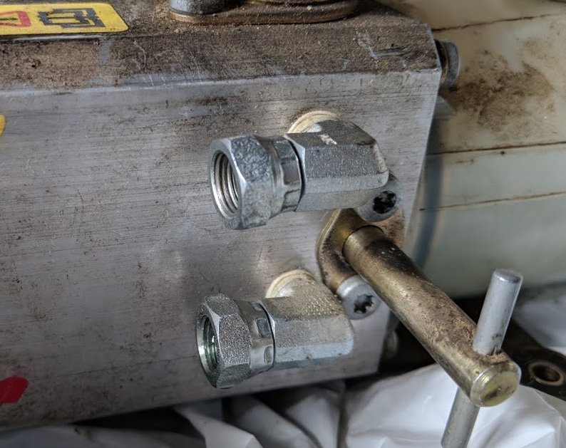

So this weekend I'm ready to install my new gear, and just as I get to the pump to start marking & disconnecting hoses, guess what I see?
Using brake lines as top hydraulic hoses (or the curse of a cheapskate prior owner)-oekajld.png
So I guess I've got three options:
1). I send the pump in to Top Hydraulics for their rebuild, and hope they can replace the connectors as they did on the front cylinder
(I had intended to do the rebuild anyways, just, was hoping not to have to do it so soon, since the pump seems to be fine)
2). See if I can get a male - male fitting from a hardware or plumbing store to allow me to connect the new hoses to the pump as-is.
3). Drink and curse the cheapskate who did this
(not mutually exclusive)
Thoughts?

I would go to a hydraulics parts supplier and get two male to male fittings. If the length isn't an issue then you should be good to go.

Tom,
You'll find the spec for the hose end of the elbows you need in the "manual latch" link in my sig. line below. Metric. The spec for the pump end of the elbows you can of course get from the elbows you found in place. I suspect the needed elbows won't be hard to find. See, for example, Malone Specialty Inc. in Mentor, OH. (www.malonespecialtyinc.com).
(I have an extra "bench" pump here and can measure the pump-end thread if you need it. Let me know.)
I would not spend $$ on the pump rebuild. These things just don't tend to wear out with the amount of use they get in our cars. The only failures I've ever heard of turned out to be electrical and easily repaired.
(I would still drink and curse the cheapskate, as you noted.)
Good luck.

I am sure Top Hydraulics has the fittings available or tell you what fittings you need if you are unable to find them at your local hydraulic shop.

Tom,
It turns out I have a few of what you need on hand. It's this part ...
Malone / Male Metric Tapered to Tube 90 Degree Elbow - Compression Tube Fittings - Couplings by Vendor
Got them from Malone; better pricing.
Send me a PM and I'll get a couple of them to you.
