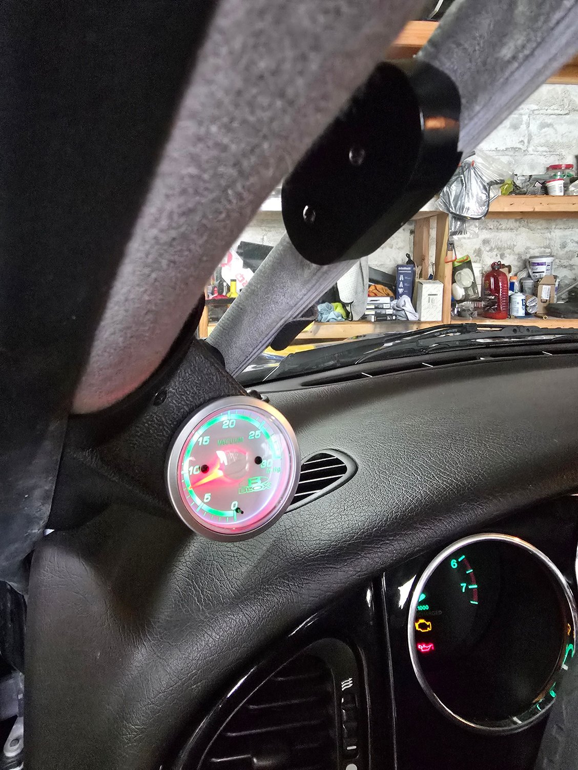

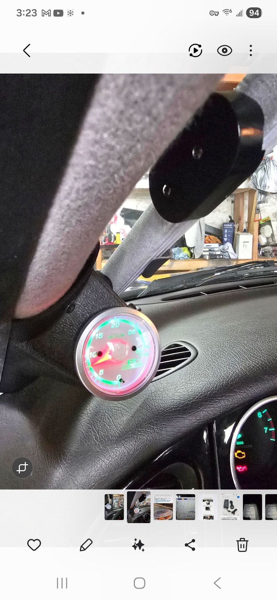

I decided to install a gauge works as it should
added pucture car running

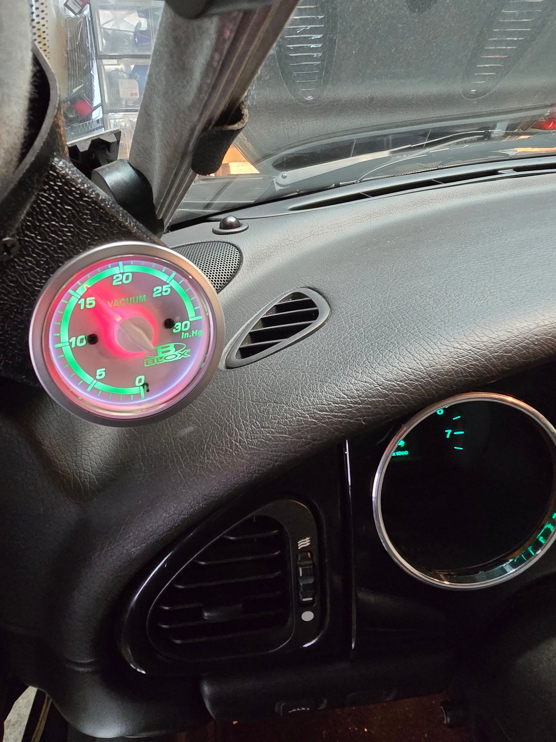

Looks low to me. Assuming you’re at near sea level and engine is at idle. Would think 15-20 would be more “normal”?
Just a thought.

that pic was with ignition swith on was going down you are correct i am around 14,15
thanks

I decided to check was cropping up tours 20

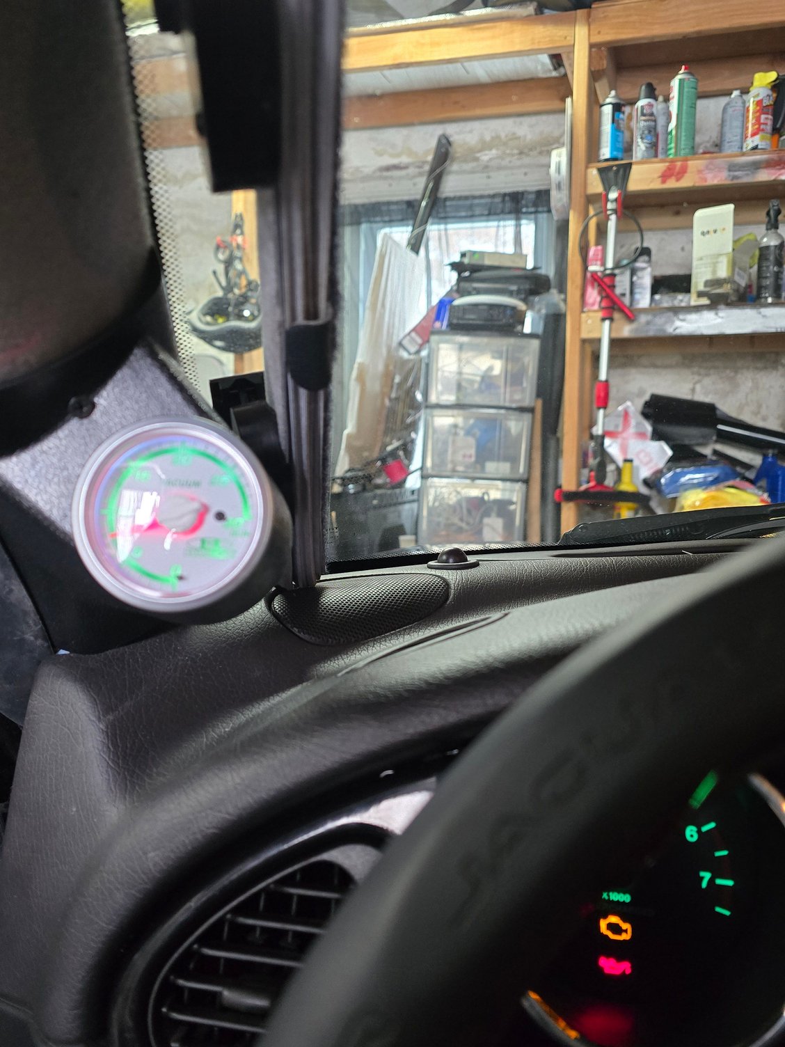

there's a rubber groomer behind wiper to feed the line i tap in to a vacuum line.front passenger side SC BY the big Hex air bleeding valve

where and / or how did you come thru the firewall ?

driver side behind the wiper you will see a rubber groomer make a small slice feed small thin rid it will show u0 by the footwell against the lower kick panel

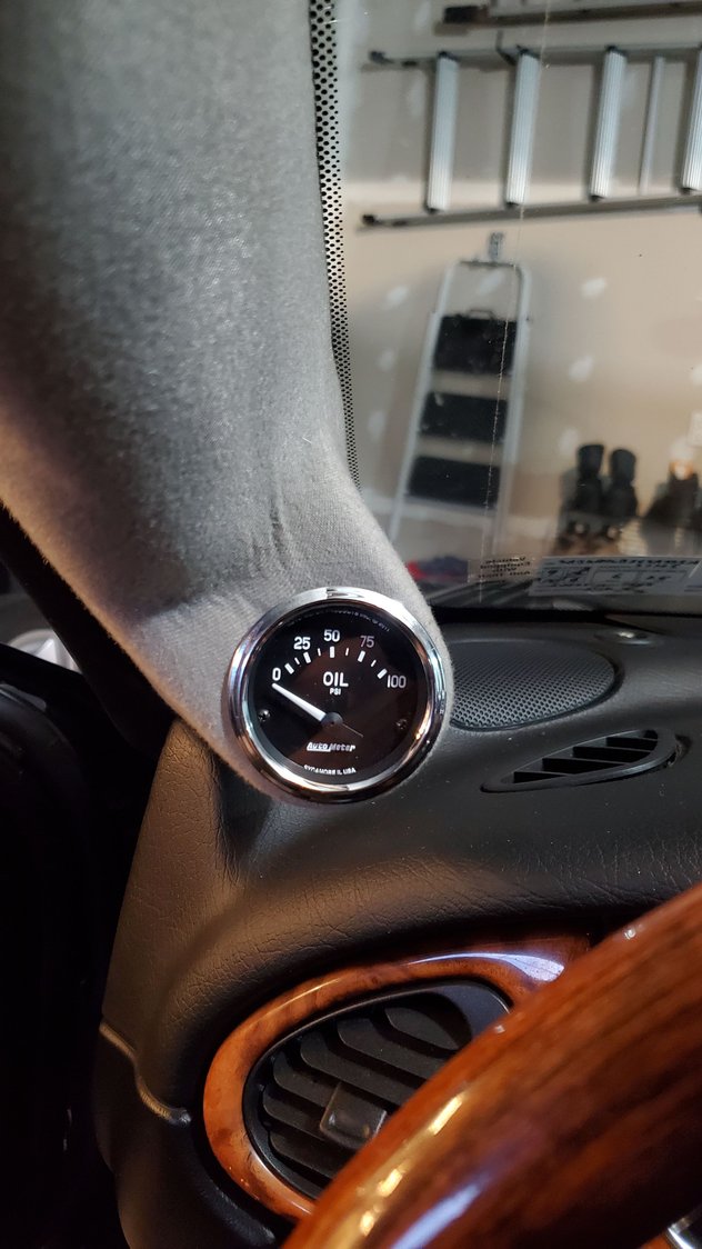

JagWrangler's instructions for installing his RealGauge conversion includes details with photos on how to snake wires (or hoses) through the firewall: https://www.thejagwrangler.com/uploa...on_rev_1.1.pdf
I followed those when I installed my oil pressure gauge:

Firewall. .Yes that is a problem. You only have the live to take to the brake light relay in the Trunk. I drilled a small hole to the right ( car right ) and came out near the pedals. The RHD if totally different in the Servo area but you may get a wire through with the Hood release.
