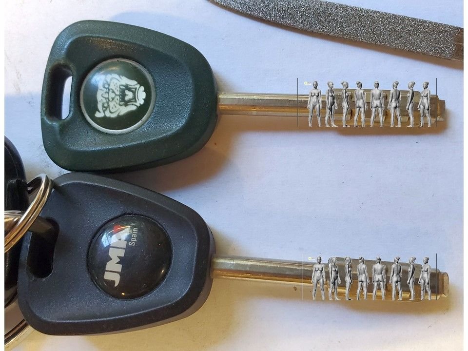

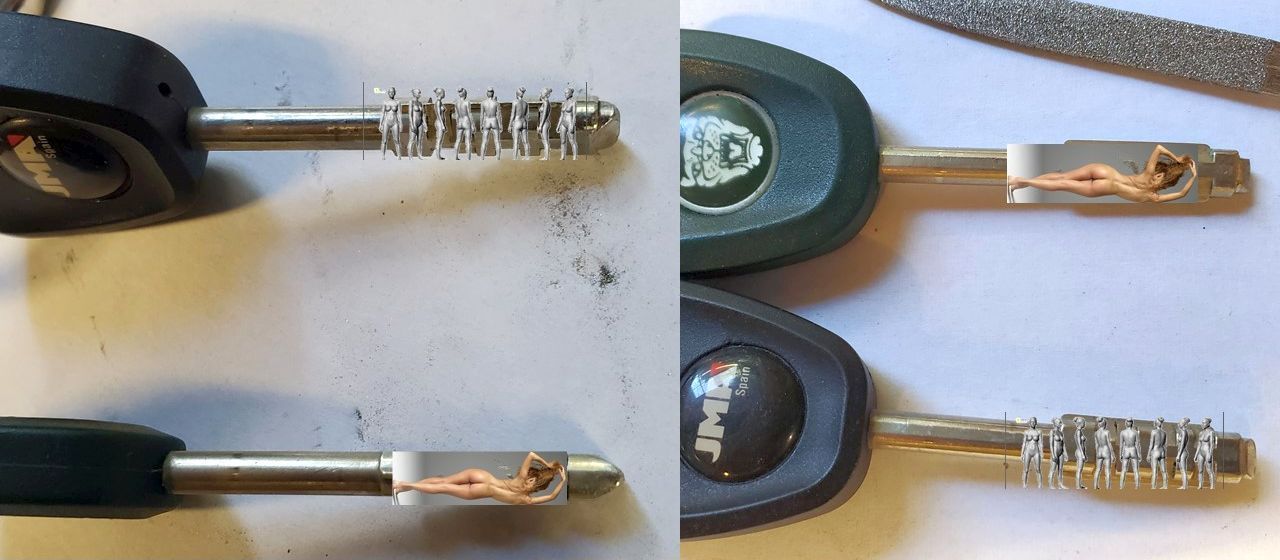

The valet key files down easily since it is such soft metal. We are fortunate that the valet is bigger than the ignition key, not the other way around. I did it visually, meaning if it looks close it will work. I posted these pictures earlier without censorship. This now has the operative key cuts disguised after getting the warning below about an 8 cut tibbe key. At least I now have a great new Scrabble word.
Originally Posted by fmertz
Unless these are random pictures from the internet, edit your post and TAKE THOSE PICTURES DOWN, or at least blur the part with the cuts. A 10 minute education is all it takes to read up on the logic of an 8-cut tibbe key. With a picture, anyone can order a copy of this key...
Green valet versus black ignition key: L-before, R-after
Contour easily matched with small hand file

Originally Posted by jagophile
... I posted these pictures earlier without censorship. This now has the operative key cuts disguised after getting the warning below about an 8 cut tibbe key. At least I now have a great new Scrabble word....
Just as an aside, not clear the censoring accomplishes much. With access to your car, someone who cared could get in it and your trunk in a few minutes without these pictures and without having your key cut. For that matter, if it's a vert, seconds into the interior through the top or through the window for both if no sh&*s were given.
In any case, there are clever 8 cut tibbe picks (let's call them a Tibbe key 'decoder'), widely available (i.e. in various different countries) that are on sale to you and me. Decoder, pick, tomato, tomahto. I have found it irritating to show up at a junkyard and have no access to the random trunk.
I think what 'saves' us, in general, is that stealing the cars or any bits off of them is not very lucrative at this point. I leave mine mostly unlocked so that no one breaks a window or tunnels through the roof which is a time-consuming and inconvenient pain in the **** to have fixed.
