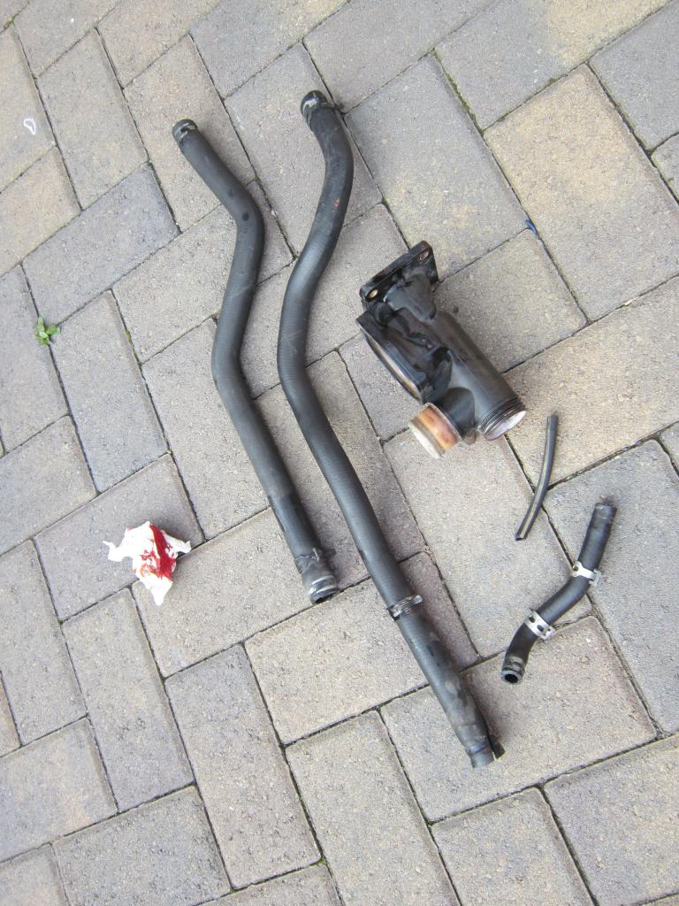

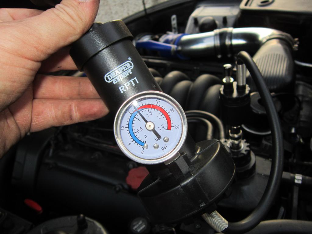

I just put some straight pipe in there (19mm I think), pressure tested it, and it's worked fine for nearly a year now

Originally Posted by franksm
Ah, the bloody bit of paper towel after a job completed. Wouldn't know how to do it any other way!
