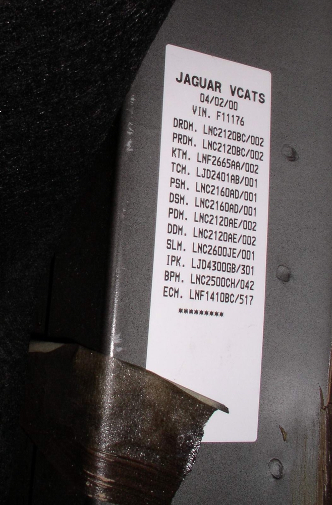

There was a VCATS label in my 2000 XJ8:
I don't recall one in either my 2001 or 2005 XK8's.

OK, so that was likey an earlier model feature.
I'm not ready to pull the cluster yet, so I was hoping for an easy way to get the numbers. Just doing my homework.
