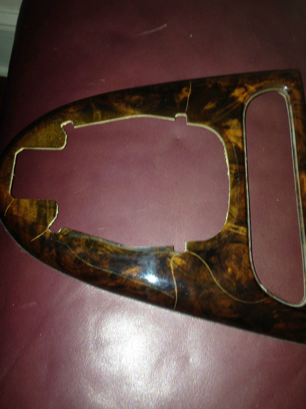

I'm working on converting my sat nav car to the triple gauge set-up, and finally found an almost perfect full matching veneer set on eBay really cheap ( I know they look different here, but they are indeed from the same matching car). Only 2 problems
1. Veneer on the shift surround is in bad shape. Since the whole set was pretty cheap, I went ahead and took the risk. So, having no woodworking experience whatsoever, can I repair this myself?
2. Surface scratch on the center panel. Veneer appears intact.
I've read on another thread that a little wet sanding and polishing will do the trick.. do you see that working here?
I considered sending just these parts to Madera for refinishing, but they said it could change the color... and I'm a perfectionist. And I'm not paying $1000+ to refinish the $300 set. So help me out

Someone recently (maybe on the X308 board?) redid theirs and it ended up looking pretty good. They used heat to remove the finish instead of sandpaper though, since the veneer is so thin.

I think ultra fine wet sanding, rubbing compound and polishing may do the trick as long as the scratches are not too deep.
As for the center console piece, is your old one fairly close in color and grain? The center console is far removed from the dash and it reflects light at a different angle so a perfect match really is not necessary.

Try 3M 39002 Rubbing Compound which is effective by hand or machine and any widely available Mothers or Meguiars polish.

The ones radiating from the cutouts to the outside edge look more like cracks from overtightening the two fixing plates than surface scratches:
If you run you fingernail over them and can feel it catch, then it's scratches. If not, then it's cracks.

Before refinishing I would try applying a dark color stain to the cracks and let it soak in. They should become barely noticeable when darkened. Then polish the clear coat several times with Meguiars liquid polish to remove scratches.
Worth a shot before refini$hing.

Thanks Rothwell. I did intend to try fixing it myself first. I mean, there isn't much permanent damage I can do. If the veneer is cracked, they'll have to re-veneer it anyway...
So, if they are cracks in the wood (which is likely given Graham's suggestion about over tightening the screws) I will lightly wet-sand the varnish down, add a little dark stain, then compound and polish. Correct procedure?

Before sanding at all I would try pouring some stain into a pan and lay the whole piece in it for a while. Let nature do the rest. The stain should seep in with a little patience.

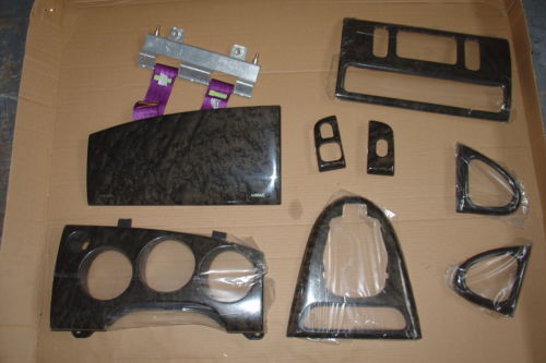

Although the Facia Veneer set is made from a single veneer from left to right across the width of the vehicle (item 2), the Console Veneer (item 3) is only a match for wood type and colour. Any slight difference in veneer pattern isn't really noticeable because it's away from the dash.
Veneer repair: Amateur Hour-dash-set.jpg
Could save yourself a lot of $$ just sourcing a good used Console Veneer in the same wood instead of going down the refinishing route.
Console Veneer is identical on LHD and RHD so you have the whole World to find one.
