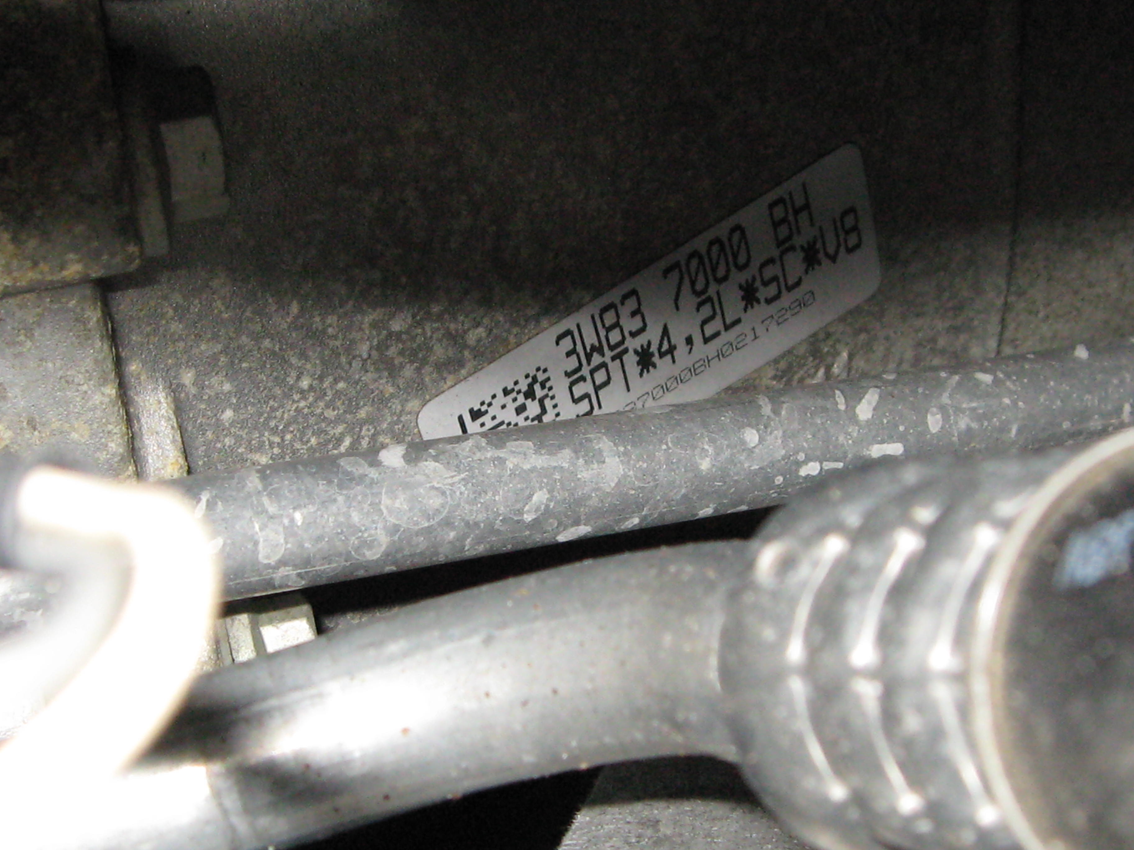

Look for this label at the back of the engine, near the firewall, close to the bell housing on the drivers side. The label will provide all the data you need plus date of manufacture.
Cheers!

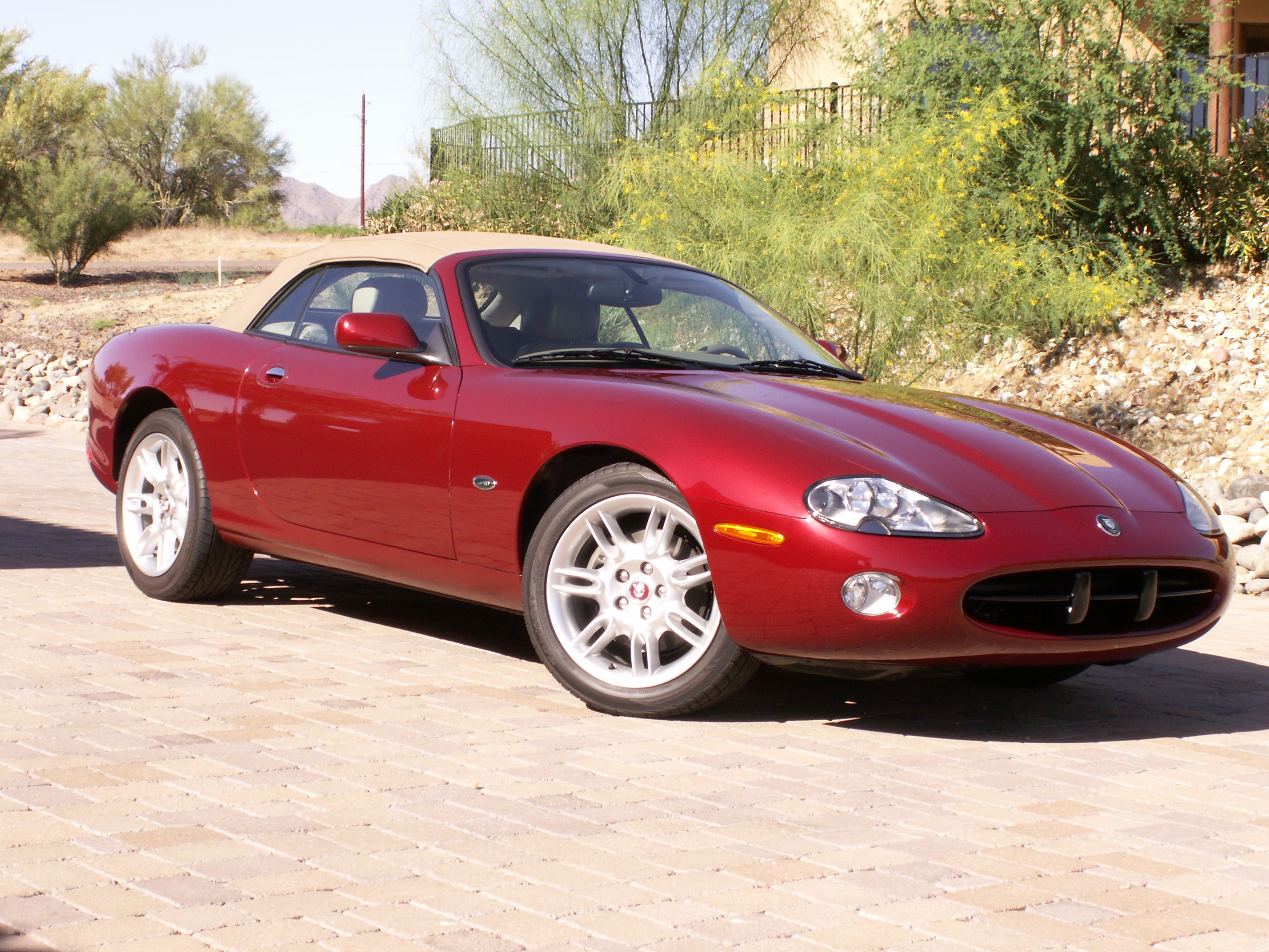

Side guards are missing on my 02MY.
That sure is pretty Steve, but not original. A prior owner definitely took them off at some point in its life.
Old Oct 18, 2010 | 11:04 AM
H20boy's Avatar
Posts: 11,345
Likes: 1,165
From: Oak Ridge, TN
I think steve did that himself
