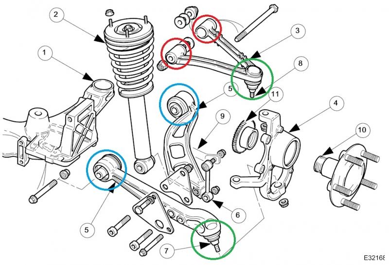

Bushings and Ball joints go out on these cars and will create this type of issue, Even if you try wiggling them you won't know. Some get kits to replace them, some use rubber other polly.
Attached Thumbnails Vibration. 2000 XK8 convertible. Approx. 58K miles-xk8-front-suspension.jpg
