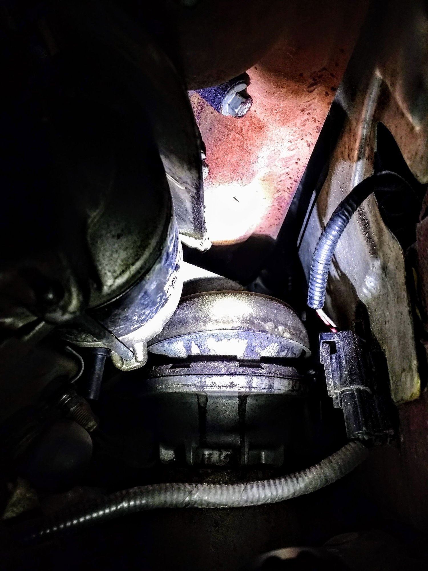

Default Pictures of mounts
Put it on the lift today, and find that the rear "dampener" on the trans bracket has been cut off. Found a replacement mount on Ebay, so went ahead and ordered it. May not be the issue, but can't hurt, since Jag felt it was important enough to put it there in the first place.
Also took pictures of the two engine mounts. Driver's side looks good, but there are possibly some signs of fluid leakage on the passenger side. I also had the normal Power Steering line leak on the passenger side, so this could be PS fluid residue. But based on the location ( sort of underneath the rubber top of the mount) I'm thinking it is the mount. Let me know if you concur.

Update. Bought a replacement transmission bracket with the Dampener. However, couldn't get the bracket out without dropping the exhaust, so decided to check the mount itself. Mount was bad, so replaced it on the bracket that does not have the dampener. Most of the vibration resolved, but still a little. Would like to swap the bracket, but reluctant to disconnect the exhaust if I don't have to.
Had a neighbor rev the car in gear, with the brake on, while I watched the engine. Left ( driver's) side of the engine bounced up about 4", so left side mount is bad. Found that strange, as the right mount was the one that showed some signs of leakage. Anyway, ordered 2 engine mounts, and will replace both. I'll let you know how she rides after the install.

FIXED: Got the new mounts installed today. Driver's side came out in two pieces. Passenger side was headed toward failure in the same manner, but not quite there yet. New mounts, with the new transmission mount, have solved the vibration at idle.

Was going to tell you that the engine mounts and trans mounts are likely bad but you figured it out. That purple oil staining is the hydrofluid inside the mounts to dampen nvh
