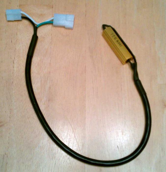

I received enough parts to make a prototype of "Pressure Reducing Resistor version 2.0". I learned a little bit from version 1.0 and I decided to make some improvements. Instead of putting the resistor physically in series with the wires, I decided to branch it off. That will make it easier to use the double-sided thermal tape to tape it to the equipment rack. Electrically it is identical to v. 1.0, but I think this will make for a slightly easier installation. The incoming and outgoing connectors are only a couple of inches apart now. The wires are jacketed from one end to the other, instead of merely being twisted together like on the first version. And there is shrink-wrap tubing on both ends of the jacket to give it a finished look. The shrink wrap is the kind with adhesive in the middle, so it's not going to move once shrunk.
I don't like that I use a black wire going down to the resistor and a green one coming back, but that's what color wires were in the cable, so that's what I had to use. The white wire stays continuous throughout the circuit, and it can only be plugged in one way, so there's no risk of getting the wires crossed. Version 2.0 will also include a piece of the thermal tape.
I can still make version 1.0 if that's what you prefer. THESE ARE NOT SHIPPING YET. I'm still waiting for the resistors. They should be here one day this week.

Cute!
You never had to draw schematics and jumped to physical installation!
Perfect!

Hi Sam, I received today your voltage reduction kit, also received the thermal tape you recommended. I like to say that your kit quality and craftsmanship looks superior as any of the OEM electrical wiring I have seen in this car. Plan to install it tomorrow, let you know results. Thanks!!!!

Interesting... I used the thermal tape on my car earlier this evening. I guess I was expecting some sort or metallic double-sided tape, but it's not like that at all. It looks like a sheet of wax paper with a sticker on it. You peel the sticker off of the wax paper and stick the sticker on the resistor. Then you peel the sticker off of the resistor and it leaves behind a super-thin layer of really sticky glue-like stuff. There is nothing to the tape except the glue, which makes sense, I guess, if the goal is to have the best possible thermal conductivity. If there was a layer of foil or something like that in the middle, then it would require two layers of the glue, which would probably reduce the thermal conductivity.
So when you get your kit, the little white sticker is actually the thermal tape. Don't throw it away.
