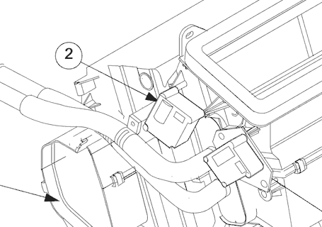

I had a jeep grand cherokee 02 that had a real issue with the blend doors breaking, they went thru selftest and the arms would overpressure nad break, lots of people upset and Jeep never fessed up, that said here's from the JTIS I suspect you may have a bad servo in the UADB
The upper air distribution box ADB, is fixed to the defrost duct and facia assembly, and seals by contact pressure to the outlet (top) of the air conditioning unit. The ADB incorporates two servo motor operated flaps which regulate airflow to:Windshield and door drop glassFascia center and end of dash (EOD) ventsAir is ducted from the ADB to the fascia air outlet vents. The center vent duct incorporates a baffle plate which balances the volume of airflow between the center and EOD vents
You might check any fuses that feed these servo #2 in pic, I imagine getting to them is a pain.
