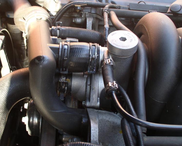

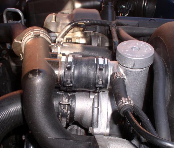

Check the difference between the swollen original hose on my 2001 XK8 here:
And the new replacement:
No chance of doing a temporary 'get you home' fix if this stumpty hose bursts.
