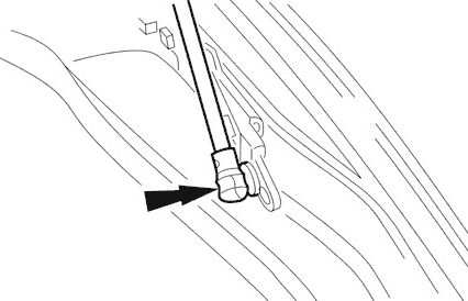

On all my recent Jaguars, the luggage compartment lid releases on the button or the switch and opens by about an inch. It can then be lifted easily with the assistance of the struts and stays fully open.
It takes little effort to overcome the strut support to close the lid.
This is what I take as 'normal' behaviour.
Replacement is straightforward. No reason aftermarket struts should be any less quality than OE Jaguar as they are a 'bought in' component.
1. support the lid in the open position (it's surprisingly heavy when not supported by the struts). A piece of timber is adequate or an assistant to hold it open.
2. release the upper retaining clip and pull the strut off the pivot. The spring clip can be pushed up with a small screwdriver to release it.
3. release the lower retaining clip, pull the strut off the pivot and remove it.
4. fit new strut to lower pivot and secure with retaining clip.
5. extend the strut and attach to the top pivot. Secure with the clip.
6. repeat for the second strut.
7. remove the temporary support
Attached Thumbnails weak trunk struts - RESOLVED-xk8-upper-boot-strut.jpg   weak trunk struts - RESOLVED-xk8-lower-boot-strut.jpg
