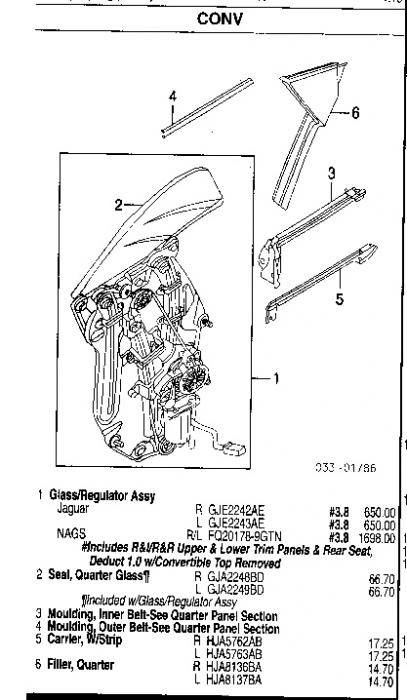

I'm after a part number for my 2003 XK8 (UK) convertable. Can anyone help please.
The part I'm after is the rubber seal (I think Jag refer to it as a weather seal) that sits on the quarterlight nearest the door. I've uploaded some pics here
IMAG0067 | Flickr - Photo Sharing!
As you can see it's all creased and I'd like to replace it. Can anyone help please.

this should help, part may be superceded by another, but any dealer will now that and get you the right part.
this is from a parts diagram file that we provide in our FAQ thread at the top of the XK8-XKR subsection, and there's plenty more to read and download there also. New member restrictions may apply for some items however, so take note.
