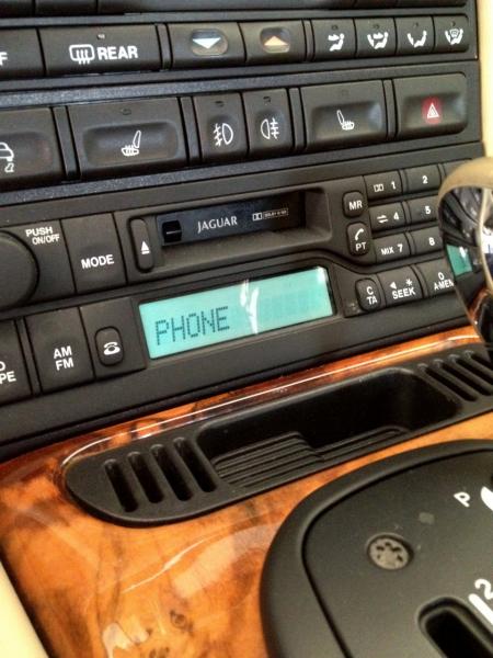

5) Parrot CK3000 Bluetooth

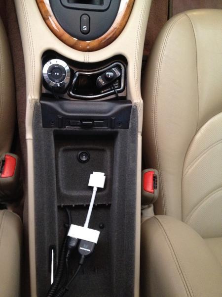

At the end I have music, movies and can even browse our favorite web forum, all from the comfort of my seat. I chose the Parrot 3000 mostly for the small size of the controls so I could mount them within easy reach. I purchased the applicable connectors for the console and overhead mic and made up a plug in harness for the Parrot and the microphone.

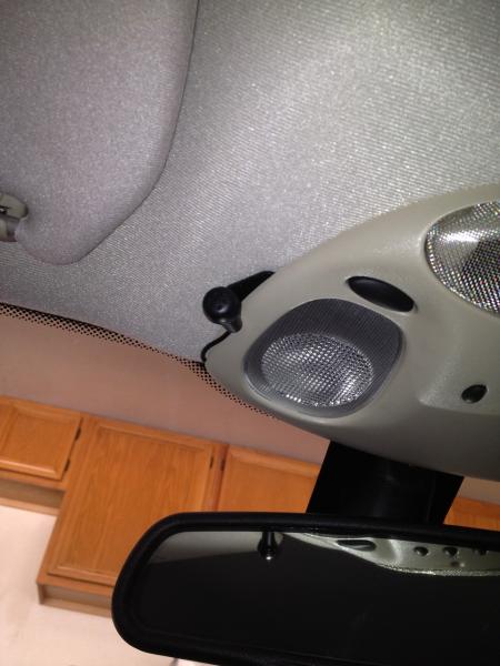

While I had the console out I removed the ash tray cover to make more room for the wiring and decided to use the stock overhead position and existing wiring for the microphone. I have read that this can be noisy but it seems to work well enough in a coupe.

Controls conveniently at hand. Parrot on the right, iPod on the left. Please don't read too much into the Monster brand, I wouldn't normally do that, but it was cheap on ebay. One hiccup seems to be that the controls work great when connected directly but don't work when using the iPhone adapter. Will have to see what I can do about that. The switch is part of WhiteXKRs VCI-X setup to select between the HDMI input and the stock nav system.
Mic installed in the stock location

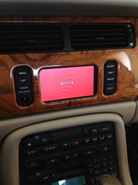

It's alive! Not only that but with an iPhone 4s I can even use Siri with the hands free system. It feels a little strange to talk to your car and have it talk back.

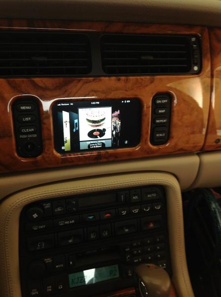

Music works great and there is even album art
Video is perfect, but still having a little level triggering trouble with the audio on quiet parts and dialog

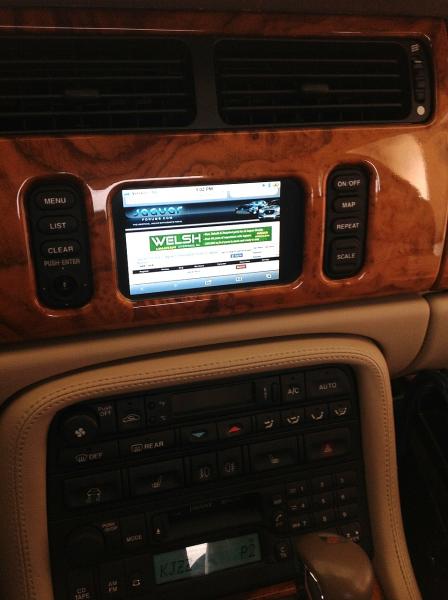

Web browsing. While safely pulled to the side of the road of course.
