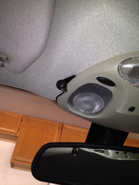

How did you talk your wife into letting you park the car in the kitchen?
I made a logical argument. "You get to keep your shoe collection in the house so..."
