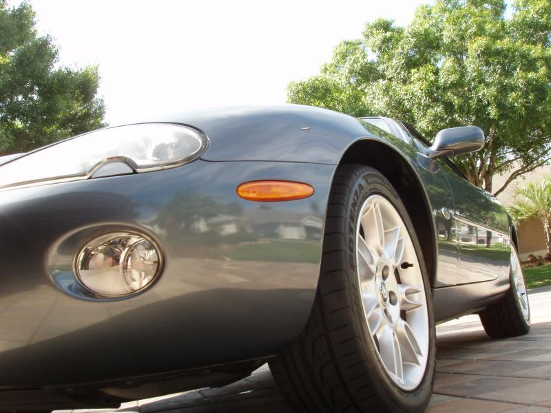

I believe Matt (H20boy) has Hankook Ventus on his car and he has a nice writeup if you search for it.
