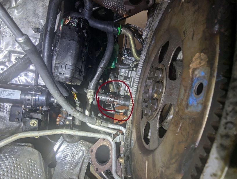

I have my transmission off and noticed a pretty strong coolant leak coming from this 3-way connector. I am thinking I should replace the connector and maybe cut a bit of the hoses off to get a new seal, hopefully there is enough play in the hoses to cut off a qtr inch or so.
I already wiped up the fluid, but it was a good amount.

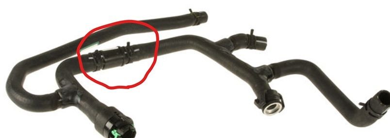

That's part of the overall "octopus" rat's nest. The T-connector is made of composite and rots away and leaks after a couple of decades. Here's a link so you can see a pic
https://www.autohausaz.com/pn/642_20...7-JG-NNE3944BA

At least it's a cheap replacement (around $5) NNE3944BA. Replace the 'O' ring at the same time:- it's on the mating connection on the octopus.
However...
If the octopus and valley hoses are of any age, then they're candidates for some PM. depends how deep you want to dive.

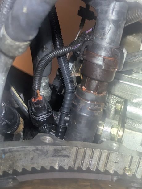

the octopus hose is still supple but it is so easy to get to with the transmission out, i figured i would put a new one in. I did notice a small leak from the connector in the center.

Yes - that's yet another biodegradeable part & fairly common failure. It is available separately ( MJA6732CA ) but expensive (~$50).
Probably better to bite the bullet and replace complete, although the OEM octopus is beyond the $200 barrier these days
You've also got a nice clear shot at the heater pump while the trans is out
