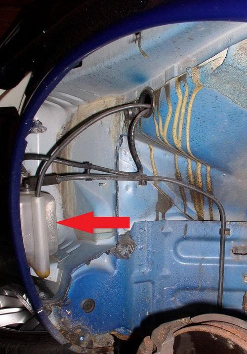

Here's the coolant flow and containment. I've taken the diagram from JEPC and removed everything except the essentials:
On your early XK8, there's 2 Bleed Hoses (items 7 and 16) from the Radiator to the Expansion Tank (item 1). On later vehicles, Bleed Hose 16 is deleted and the second Expansion Tank inlet blanked off.
As the engine warms up to operating temperature, coolant expands in volume and the excess passes from the Expansion Tank to the Atmospheric Recovery Bottle (item 11) along Expansion Hose (item 8). The Atmospheric Recovery Bottle (arrowed in red) is mounted behind the RH wheelarch liner.
When the engine is switched off and cools down, coolant is drawn back from the Atmospheric Recovery Bottle to the Expansion Tank to maintain the correct level. As stated above, this is normally a few millimetres below the filler neck.
If there is too much coolant in the system, excess from the Atmospheric Recovery Bottle is dumped through the Overflow Pipe (item 17) onto the ground below the vehicle.
