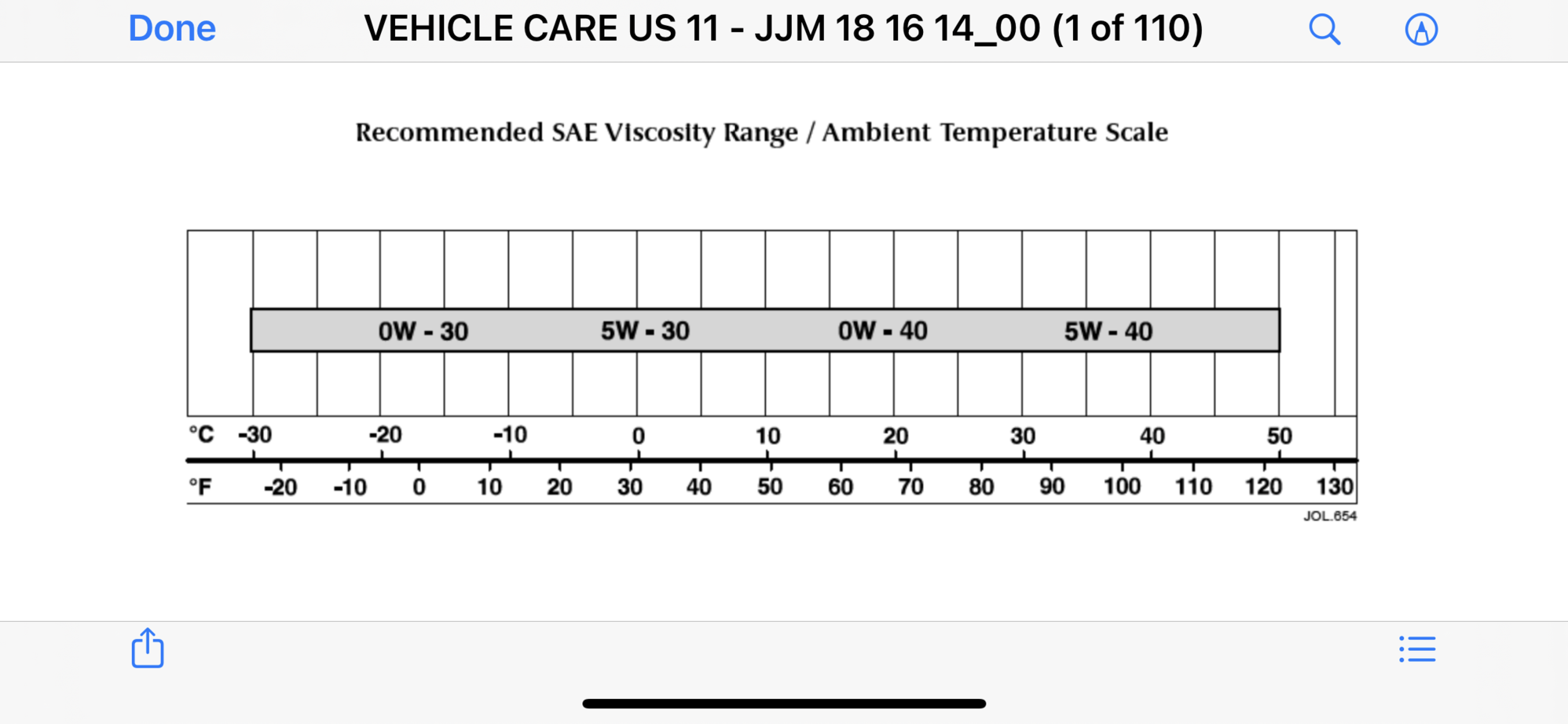

Here is the factory take on recommended viscosities. You can see it’s a sliding scale based on the ambient air temperature in your location.
In my locale I use Mobil 1 0w-40 exclusively, summer and winter (the XKR is my daily driver). Unless the oil change happens to come during the really brutal summers, in which case I go with 5w-40. Since I drive the car about 15,000 to 20,000 miles a year I go thru a lot of oil. What’s in the engine in the summer is very likely to be replaced by the time winter rolls around. Maybe not the norm.
