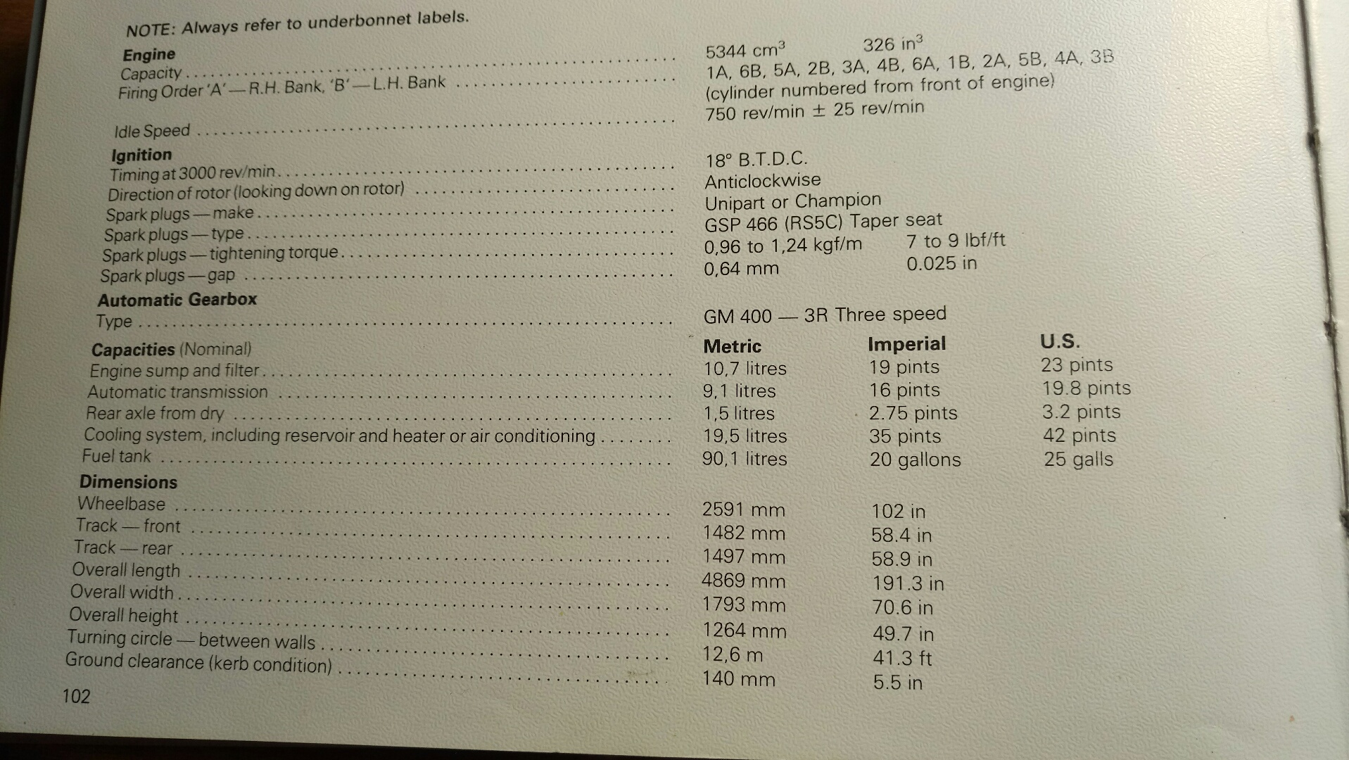

What quantity of oil goes into the V12 ?
Old Mar 21, 2017 | 08:27 AM
Daim's Avatar
Joined: May 2014
Posts: 5,906
Likes: 2,182
From: Bremen, Germany
Something like 11.5l or so goes into the V12 but that is full flow oil cooler... Also, you won't get all the oil out.

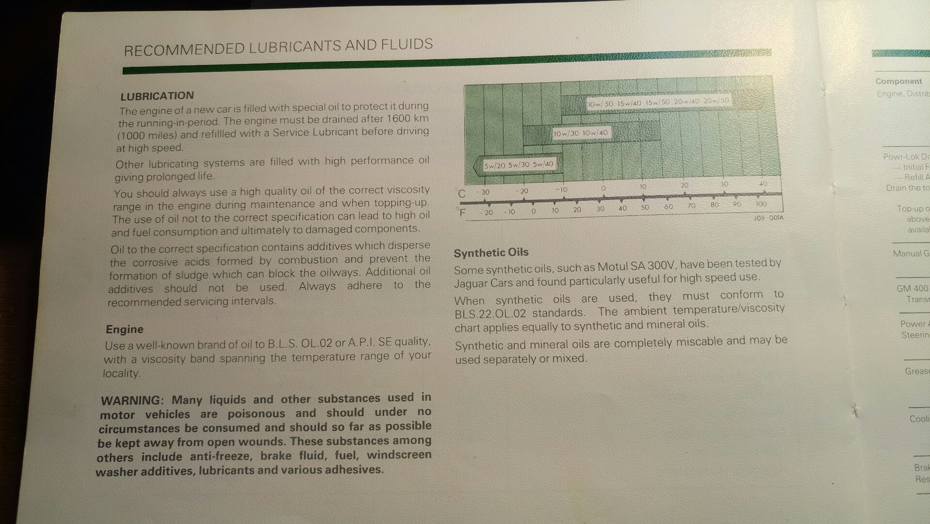

Old Mar 22, 2017 | 06:44 PM
NJ2003XJ8's Avatar
Posts: 429
Likes: 125
From: NJ, USA
This should be it...
