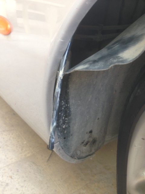

My 2002 XK8 has been loosing cooling fluid at an alarming rate (~1L per drive) but hardly any when off. The coolant is dripping out the right hand side wing just behind the wheel arch.

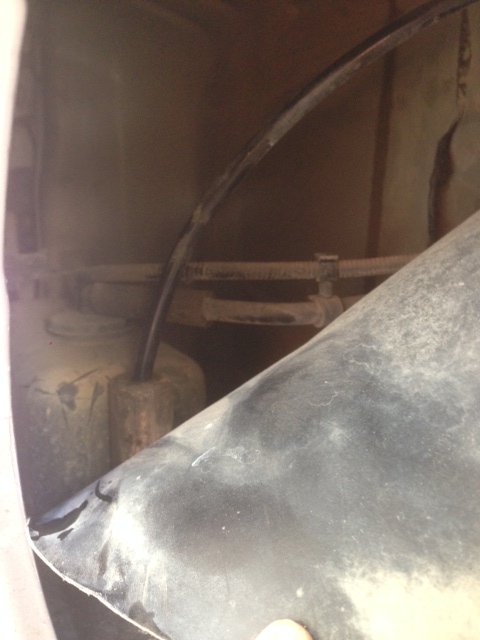

I pushed the wheel arch lining to one side and found a black plastic pipe (pics), through which hot water leaks out when the car hits temperature, and hot water/steam gushes out when the enjoin is turned off when warm.
WTF is that tube and WTF is it doing that?

That is the overflow reservoir. It isn't sealed and pressurized like the rest of the system, it's just a place for the extra fluid to go when it pushes past the the pressure cap.
There should always be some amount of fluid in it and the tube should be submerged, the idea being that the overflow goes into there when the engine is hot and as it cools down is sucked back into the reservoir up top.
My guess is you have a bad pressure cap and it isn't keeping the system at the right pressure so it's ALL coming out the overflow.
Not having pressure in the system is a serious risk for overheating as that will let the antifreeze boil inside the engine, so something to check and get fixed fast.
If you don't mind not having the Jaguar leaper on the cap, they can be had pretty inexpensively.

what you are looking at is the "overflow pipe", number 17 on the linked picture:
https://www.dropbox.com/s/mycxabeymk...erflowpipe.png
As I read the description of your problem ... , some time ago when I bought an XJR I had a similar problem. The cause of it was that someone swapped the hoses connected to the expansion tank. Check if they are all connected to the proper place.
good luck.

And that bottle should have very little coolant in it. If its full cold it will push out the excess coolant on the ground.
