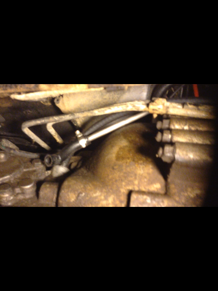

Hi I'm new to the site this is my first jag purchase that I coundnt pass up well at least I thought it was a steal for $500 with 136k all original exterior & interior in great condition, all electrical works. It doesn't go into reverse but all other gears work fine, ac has to be charged. She gave me the cover, original manuals, Maintenance/repair books that came with it the radio plus a newer radio that's in now, I picked it upmlast nite for my 30 th B-Day as I'm driving home it overheated so I pulled to to the side to check it & I found either coolant or water gushing out on the passenger side, I ran to a target to get some coolant & liter of water it was pouring out again so I got it towed home took pics of what I think it may be coming from. Anyone know what these are or what supposed connect to & will it be an easy fix Thx

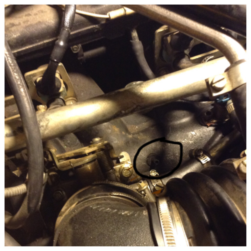

It's an 84 S3 4.2 here's another pic hope it loads Name:  9f4d44e799ea7c6a78bab3d02121301d_zpse7e1f17d.jpg

the picture on the right is the a/c water drain, leave it alone.
the picture on the left is the one you want to find out where it goes; Mine is a 1984 too but I can't figure out where that rubber hose elbow connects to, although I have a feeling it is the coolant bypass which should be connected on the passenger side of the water pump. Not even sure of that because the metal tube is throwing me off. Maybe if you show the area from far away?

Hope this a better view & does it connect to the heater water valve?

Looks like we're seeing the right side of the transmission.
Does that pipe sorta run upwards, and then downwards, alongside the starter? If so, it's the transmission vent pipe and the small bit of rubber hose goes to a nipple on the transmission case....almost at the top of the case, slightly towards the right side of the case

Hey Doug, I think I found the transmission case nipple it connects to but I'm not sure what type of hose to get to attach them with & could this be the reason why she doesn't reverse?
