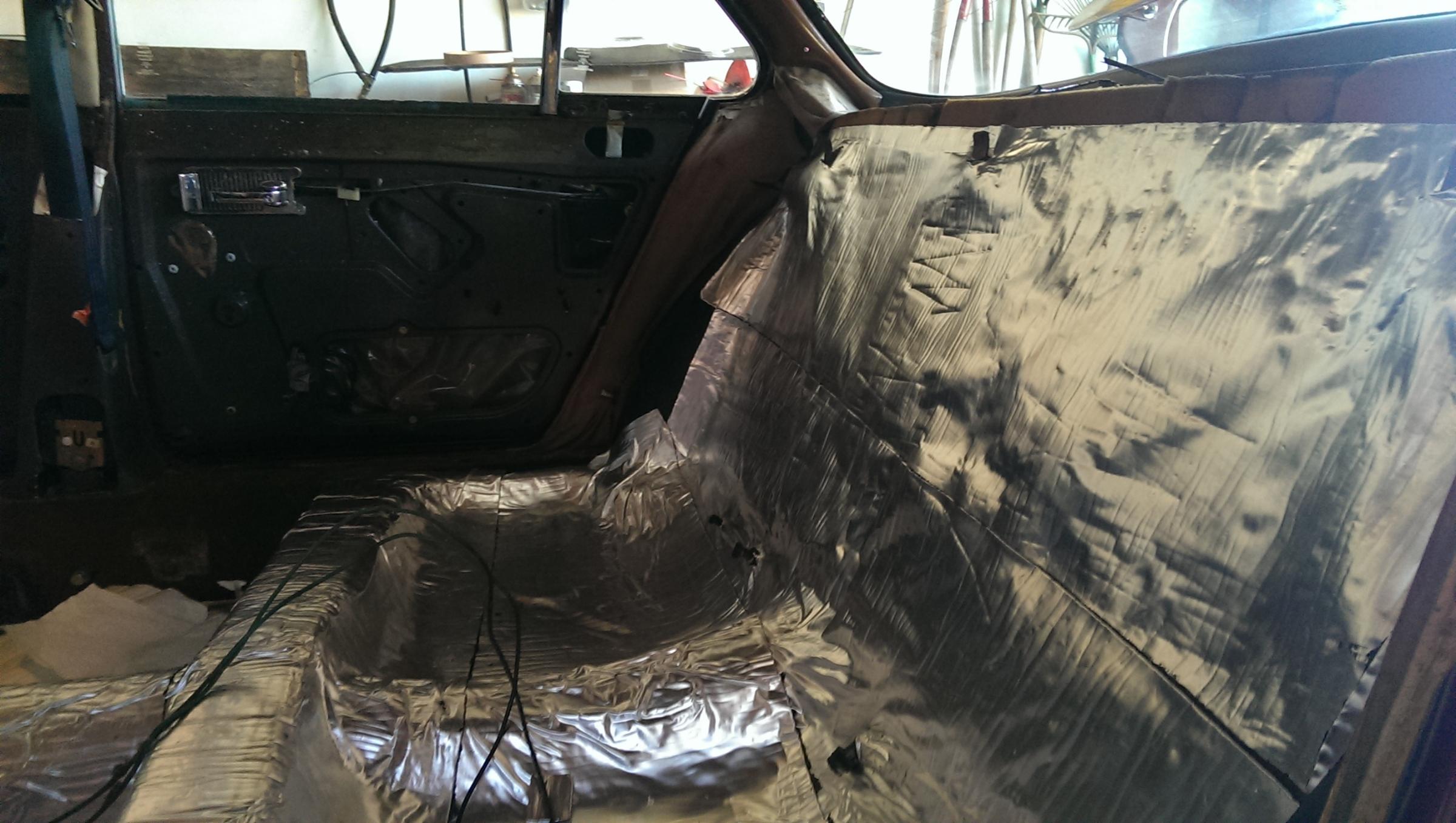

Default Used B-Quiet in the doors and all the floors
Easy to use stuff that sticks on... just use a roller to press it tightly to the curves...
Makes a great difference in heat and noise...
Attached Thumbnails Series 1 - Engine heat coming into car-2013-09-13-14.17.30.jpg   Series 1 - Engine heat coming into car-2013-09-12-12.47.07.jpg   Series 1 - Engine heat coming into car-insulation-rf-passenger-door.jpg
I thought BQuiet was for sound insulation rather than heat?

Default Insulation does both = sound and heat and cold
It helps with all of the above. Like adding clothing in layers....
