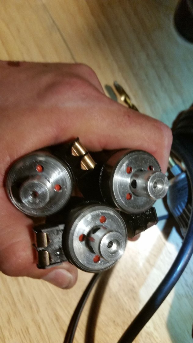

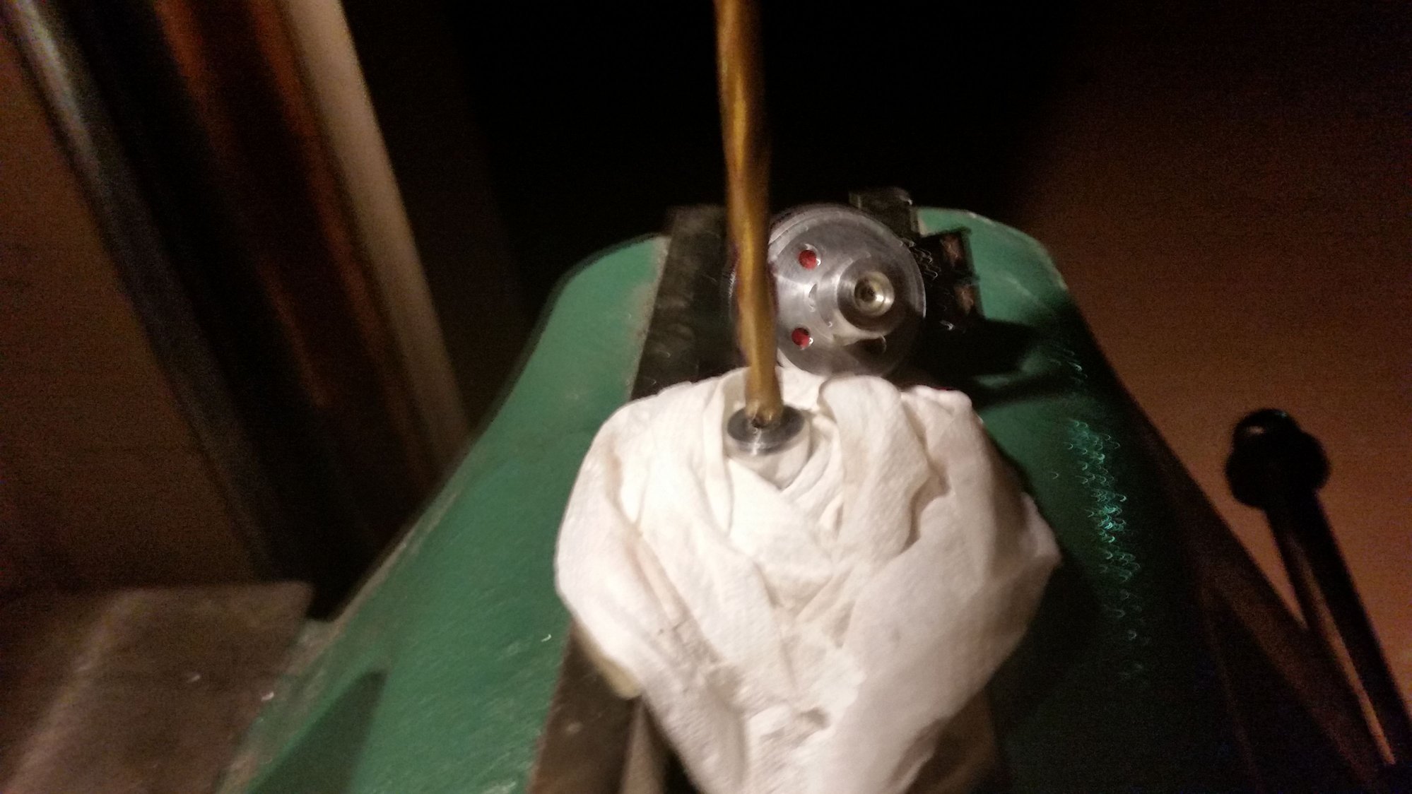

Default Drilling out brown tops to blue top size
One down and one to go. Drill is easy. Cleaning the orifice is the real job. Hope this works....

Well Ill tell you what. If you manage to get this worked out. You should do it to a few sets and sell them on an exchange basis

Default Modified Brown/Blue Tops
It's too easy. I'd feel bad taking someone's money for something anyone can do.
10 mins later including having a couple of cigarette breaks and playing on the internet with my phone.
Lets bust the companies raping us on the price increase the blues tops have seen in the last few years.
