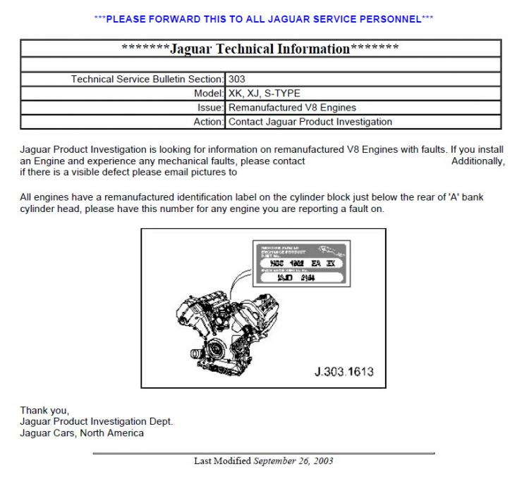

It kept bugging me that I thought I remembered there being some tag of some sort on reman engines. Finally dug up this excerpt from a technical department email.......

I checked and did not find a remanufactured engine tag. I guess with no Jag service record and no tag we can deduce that this is not a Jaguar remanufactured engine. I hope the PPO gets back to me with some info. (Or we discover a way to track the engine # back to the donor vehicle). Still have some conflicting info. in that
the solenoids are on each side of the front cam covers, indicating a 2000, yet the engine # (from the thermostat housing) is 9809071109, indicating a 1998.
