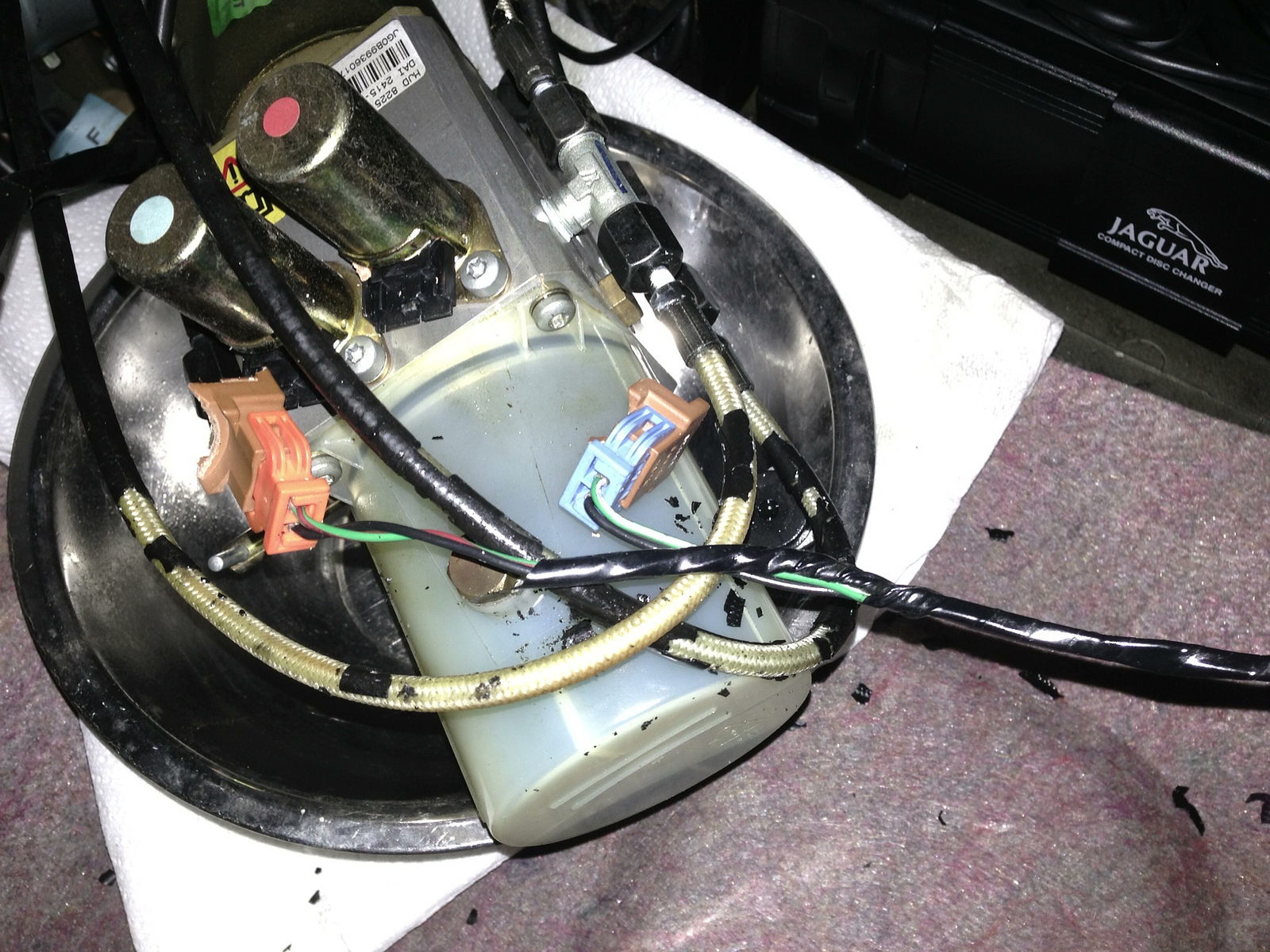

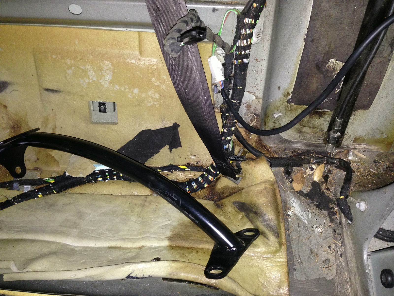

Alright, I dug in tonight after work. No obvious fluid spills or puddles... though there are some stains on the passenger side under that seat if I'm honest. The foam felt pretty dry though... Remember most of my fluid was on the ground behind the rear passenger tire and the CD changer/pump rack was definitely soaked. I believe the leak is at the pump (maybe the hoses were changed before and bled out under the seat before?). However, the black pieces flaking off the hoses were prevalent on the other ends at the (cylinders? I expected massive capacitor looking things and was surprised by what I found, let's call them) struts! Both sides as you can see below. Some debris has collected below them over the years and it's dry, lending credence to the pump-end blowout further. Scroll down for testing info...
Passenger side:
Driver's side
Well fair enough! Time to place the pump in a bowl, fill 'er up, and plug in these connectors to test it ou....ohhhhh noooo!
So now I need to replace these two... what are these called up top exactly? The whole assy. for each. Please let me know the name and where best I could find a pair to replace mine. Stopping here for awhile it appears (and won't be driving it this weekend).

Those are solenoid valves. I cannot make out the exact damage, but see if you can find a way to plug them back in, perhaps with the aid of some silicone adhesive.
I would not advise removing them, I believe the wiring behind them is quite delicate. AFAIK no one has ever identifed a replacement for them, and they are not available separately from Jaguar.
If you call Top Hydraulics, I think he will sell any combination of hoses that you want.

Thanks- I tried again this evening, but those connectors are snapped in half in the worst spot possible. Circuit boards are broken, even with the odd tiny wire sticking out. I couldn't see that far up in the fender to see these wires and didn't know they were there until I pulled it out, so my fault. Sure hope that wasn't a $400 mistake.
I left a voicemail with Top Hydraulics and will look forward to hearing back what they can do hopefully tomorrow. Next update then, won't be tinkering any further until... *looks longingly at Kate, withdrawals setting in after 10 days*

Whatever you do, as Steve says, don't try to remove the solenoids. You will wreck them and so the pump.
I can't see why you couldn't solder to the bits sticking out of the solenoids - it's only 2 wires to connect.

Definitely not touching the solenoids, unfortunately the wires are so thin, most of them are missing and the circuit board is too hard to get at, so this is going to be impossible to solder. The base connector snapped in half, so what's exposed now shouldn't be. The harness connectors (the whole Y assembly) are fine.
Got a call back from Klause at Top Cylinders today and he was great- very helpful. He said he could break up the 6-hose kit for the 4 I need for $400. The solenoids can no longer be sourced from Jaguar indeed, but it sounds like he can rebuild them with different connectors for $200. Fair enough. I started disassembling this evening right after the call and will ship him the pump and 4 old hoses.
Trouble though- these things are screwed on so tight on both ends it's become challenging. I was able to get the two good hoses for the latch cylinder off by re-mounting the pump for leverage. Obviously can't get at the back for the other four this way. I'm usually rather creative coming up with Rube Goldberg ways to get things like this accomplished, but I'm coming up empty- anyone have suggestions?
The other option is leaving them attached at the pump, but I'm having difficulty threading the old hoses out from around the back seat. Will try again tomorrow. Was surprised that the bottoms of the cylinders are not mounted to anything- haven't stared at it long enough to understand how that still works but there are no mounting points down there.
Of note for future reference, I used some White Out paint to make a mark on the good top hose so I will know which one of the two goes where on reassembly. Disconnecting the bottom cylinder hoses required a vice grip that hit the side of the car for leverage, otherwise the cylinder bottom just turns with the wrench! I have not threaded any of the four out the trunk yet.

The solenoids on top one is for the roof latch control and the other is for the rams control. If the plugs are broken you have no replacement parts available, however you may get a used unit at E-Bay. I have directed people to find a TV repair shop and see If they can make repairs. From what I can see it looks doable. The removal of the solenoids is also doable but must use extreme caution and I would recommend against it. Any contamination introduced to the pump would be devastating. As for the hoses you will need to get them from Top Hyd or Jaguar because the fittings on one lift is metric and the other lift has a special fitting.
I have a lot of information about the roof system on my page if you care to look. I would suggest using extreme caution when moving the pump with the hoses attached ANY pinching or twisting of the hoses is not recommended it WILL reduce the life of the hose.

I should mention that the plugs are color coded to the solenoids. Do not mix them up.

Wow, what a site. Thanks, Gus! Definitely bookmarked. And I did note the plug and solenoid colors. I'm going to leave those bits alone and let Top Hydraulics take care of it. By the time I carefully dug into them to see what I could do (I've repaired iPhone guts before), the risk of botching the whole pump and my wasted time isn't worth it.
I was definitely careful to move the pump with the two hoses for the latch in place before I removed them once the pump was remounted- they did not crimp. The other four that I'm replacing I will just leave on and let the shop take them off. As soon as I can get the cylinder ends disconnected and snaked out (are the driver's side hoses loose under the bulkhead cover behind the seat? Anything attaching them?), then I'll get the assy. off to Top Hydraulics. Hopefully tomorrow. I've got a lot of landscaping to do over the weekend in the meantime...

The hoses going to the cylinders are relatively easy to replace but as I said before do not tug or bend them sharply or you will be doing it again. I should also mention that the hose connections are critical and MUST be attached in the proper order to the pump so if you are going to change them mark them as you install them.
