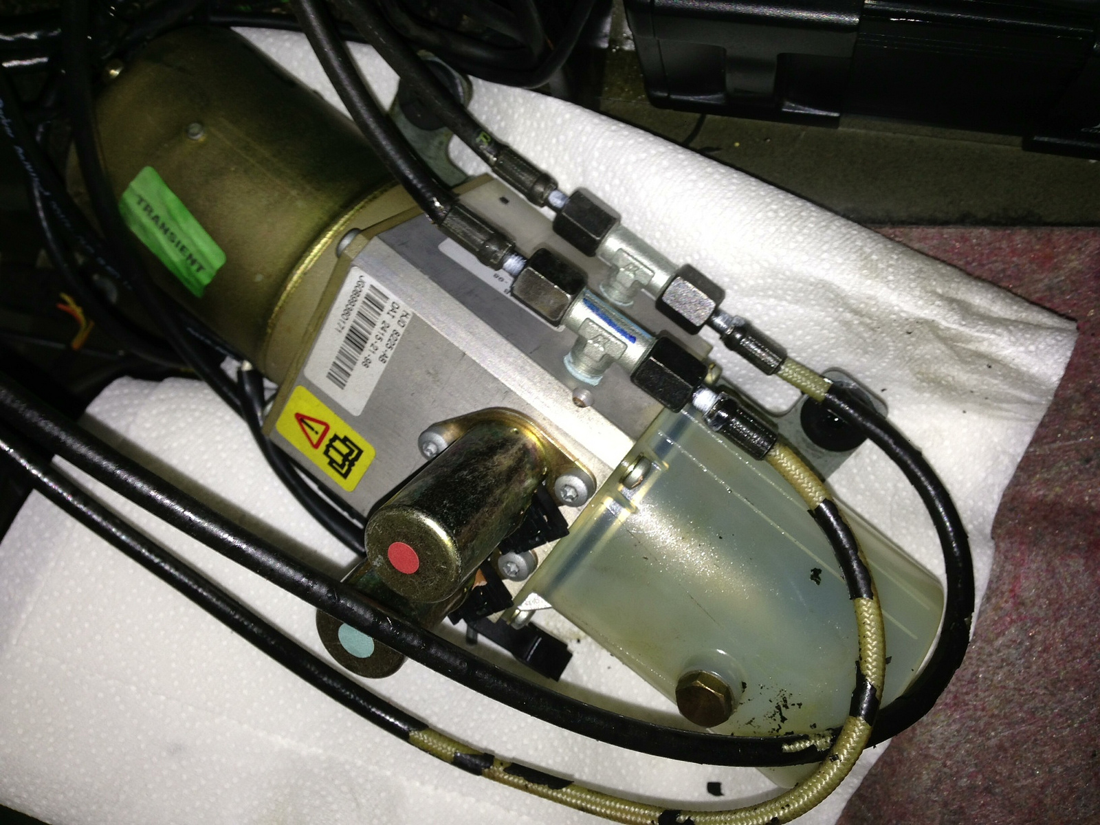

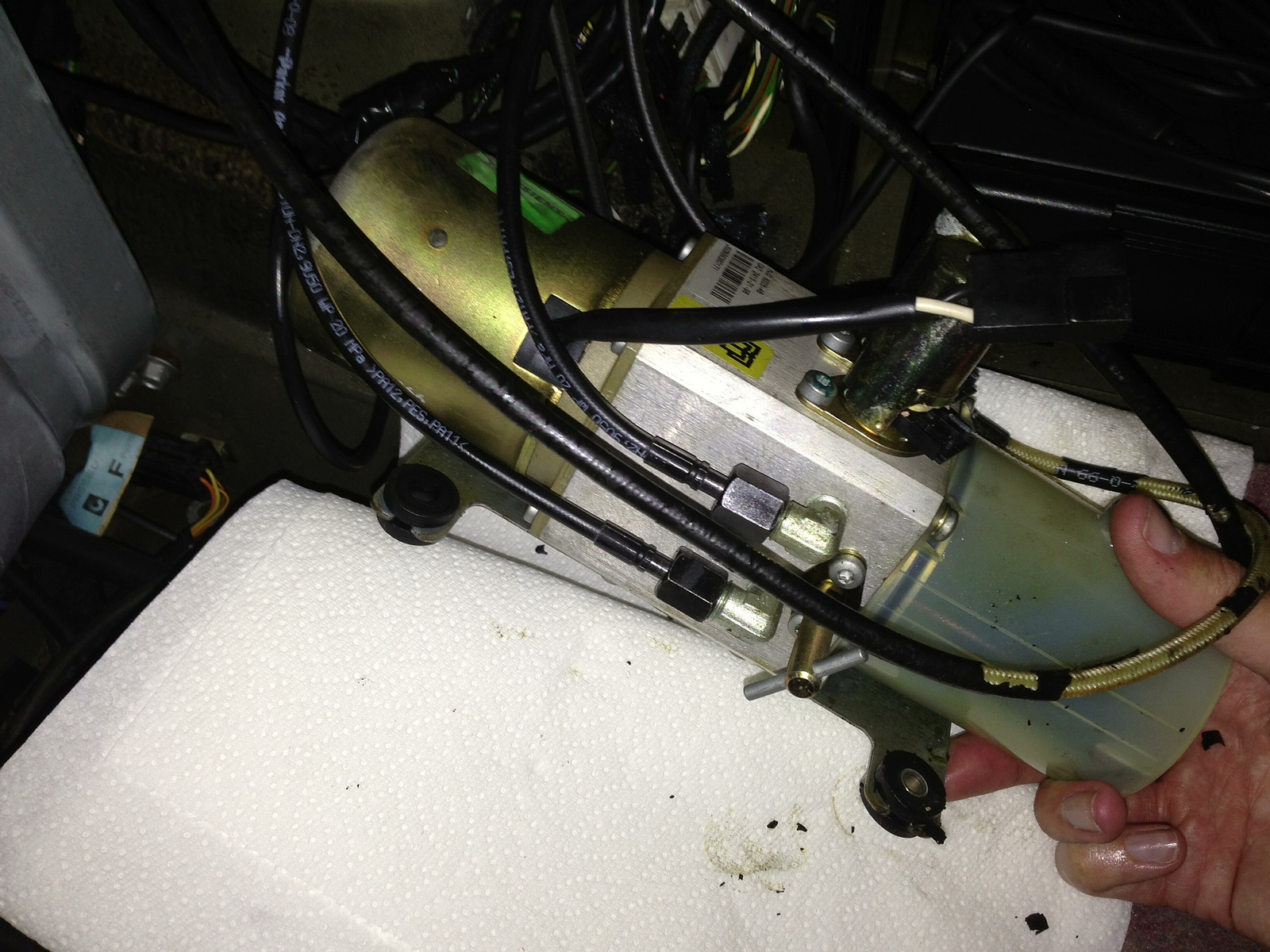

Alright, got it unbolted this evening. Sure glad there aren't two bolts in the back! Good design. There's nothing too obvious that's broken- everything's just a bit slippery from when it blew a week ago. Let me know what you think.

Should I top up the reservoir with more hydraulic fluid, try operations, and see where it's leaking next? If so, what kind of fluid is recommended? I see the bolt where to add.

The fluid is Pentosin CHF-11S. 1 Liter is plenty. NAPA should have it. Those hoses with the peeling black casing are in pretty rough shape...they are certainly suspect.
You really need to inspect behind the rear interior trim to fully imvestigate the problem.

Chris, use Pentosin CHF-11S - I was only able to find it at 1 NAPA location within a 15mile radius of me. As for testing, sure that will confirm leak location, but (and this is just me) looking at the hoses and the outer coating falling off, from my perspective I would just say replace the hoses. If you only replace 1 today, what's to say you won't have to replace one later on down the road. If you do test, just put something underneath to keep fluid from getting onto battery or electronics in the trunk.

Yeah I was going to put the pump assy. in a bucket and test it out after reconnecting power. I wondered about the coating flaking off as well. Note the two on the front are not- I believe these go to the top (?) that were replaced when it had its green shower a few years ago. The other four are likely OE. Will definitely replace all four instead of any one culprit if that's what I find.
