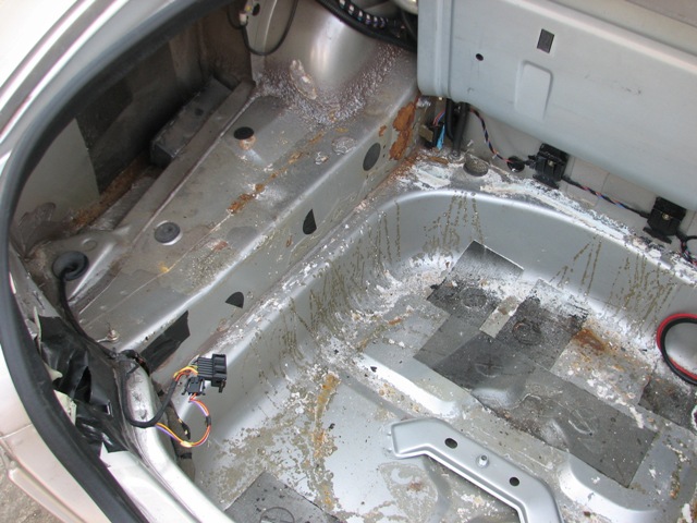

Here's a couple of pics
Not sure if anyone has mentioned this but you need to stop it from progressing, make up a paste from bicarbonate of soda and brush it on the effected area, it should start fizzing, once stopped rinse off with water and repeat the process until no fizzing occurs, then you can treat the rust/effected areas and paint.... Once I was done this car looked like this...

Wow, what a mess! My wife's XK8 trunk doesn't look nearly that bad - just some scattered white powder with no evidence of rust-colored corrosion yet. I must have caught the issue long before you managed to do so....
How did you resolve your issue after trunk clean-up and refinishing? A new battery, perhaps? Did you happen to spot any cracks in your battery casing or otherwise make a determination of where this stuff was coming from? And what type of paint did you use for refinishing?

From what I understand the car was left on charge for a considerable period of time and I don't mean a trickle charger either, this would of "boiled" the battery probably causing caustic gases to cause the damage, the owner had no idea but i did need to supply, obviously a new battery and a new spare. The space between the tyre and the floor seemed to of been a good breeding place for the white powder and ate its way through the floor.
In the top pictures you can make out the rust patch, that had turned the metal to powder, the only thing holding it together was the paint. In the last pic you can make out roughly a 6" x 3" patch I had to weld in to fix it...... I replaced all the drain plugs as I had to knock them out to let the water and bicarb soda to drain away..... It was a helluva job!

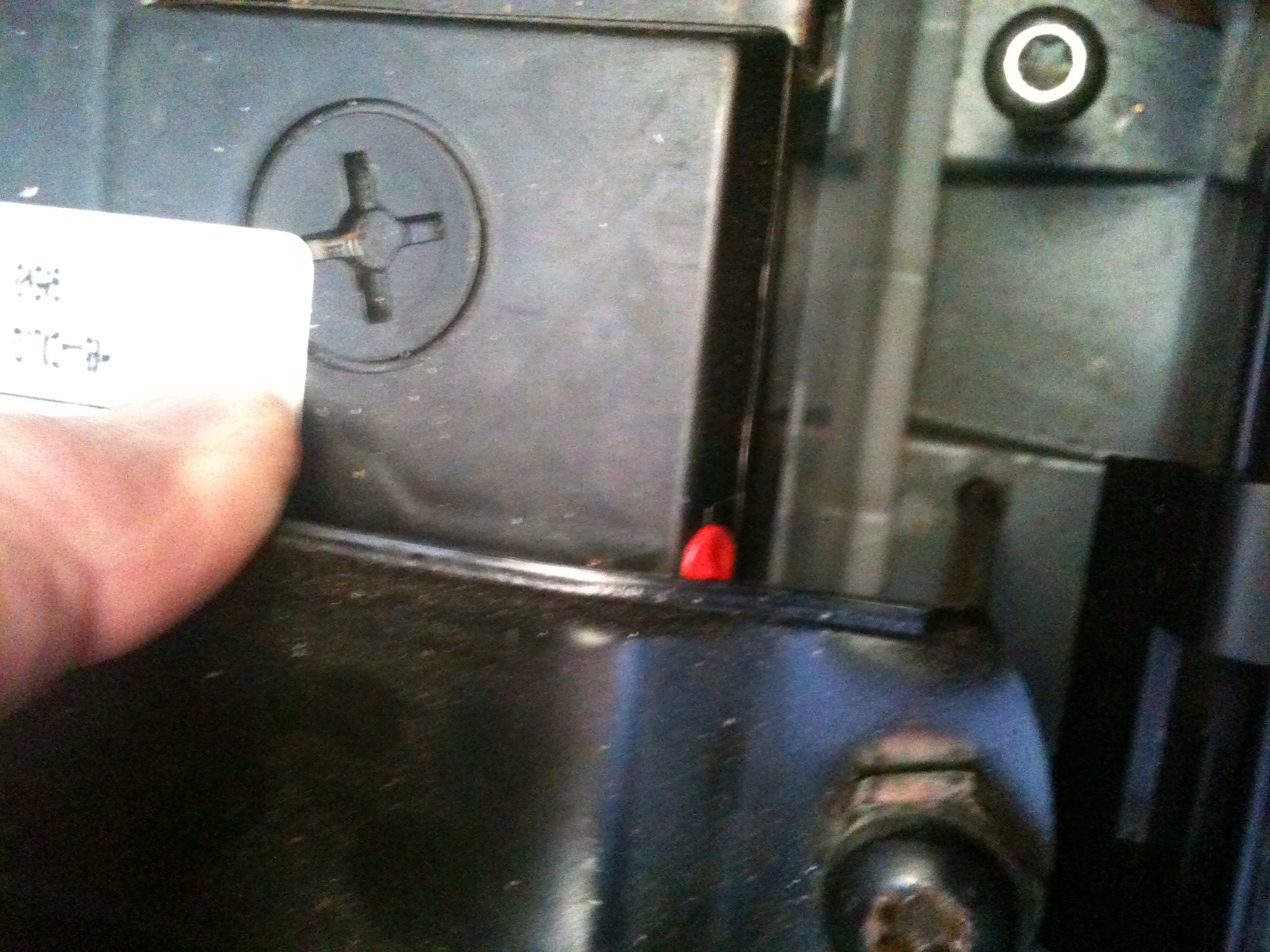

As was mentioned before, a lot of the batteries have openings for the vent tube on both ends. The opposite end needs to have a plug in it, the small red thing as seen here. Check for that as well.

If the vent is working correctly there should not be a problem. I think plums post#6 is likely the key to the problem. There are vents at both ends of the battery, and if the unconnected one is not sealed, the battery will vent to the well. When a battery is being subjected to a high rate of charge the hydrogen gas bubbles generated will carry a fine aerosol of electrolyte with them.

Just went to check out my current battery and it does indeed have the second vent as described above and it is capped, my guess is it was the OE battery previous to the one I got with the car that had leaked. Is it possible that over tightening the clamp can cause the battery to warp and leak? Anyhow, whatever you do don't try to vacuum it up, the powder is very fine and will get through your vacuums filter and get literally everywhere.
