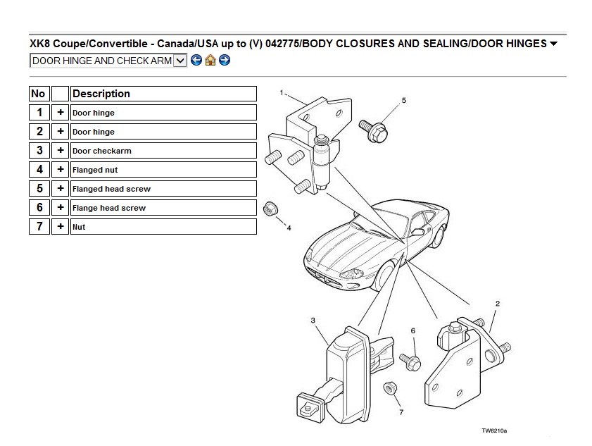

When I open and close the drivers side door, the section that holds the bolt to the car, pops slightly in and out when the door hits a certain spot, I thought this is the common "squeaky door" syndrome that is somewhat common on these cars?
Old Nov 9, 2013 | 08:29 AM
Likes: 17,010
The two nuts (item 7) on the Checkarm (item 3) which prevents the door opening fully against the front wing can work loose and create a clicking or 'popping' noise as the door is opened or closed.
Who has the best deal for a door check assembly (stay) for a 98' XK8?-xk8-door-hinge.jpg
Although not mentioned in the Service Schedules, the Checkarm should be lubricated with grease to reduce friction and keep it quiet.
As I wrote in post #2, failure of the Checkarm is unusual on the XK8/XKR unlike the X300 and X308 where having them rip completely out of the door frame is a regular issue.
Check your nuts!

As my door check assembly doesn't have any visible cracks and after reading sometimes it is just the bolts that come loose and make the popping noise, are any of screws or bolts easy to access without taking the door or panel off to see if it's a quick easy fix? Such as figure number 7 in the picture?
Attachment 61883
Check your nuts!
