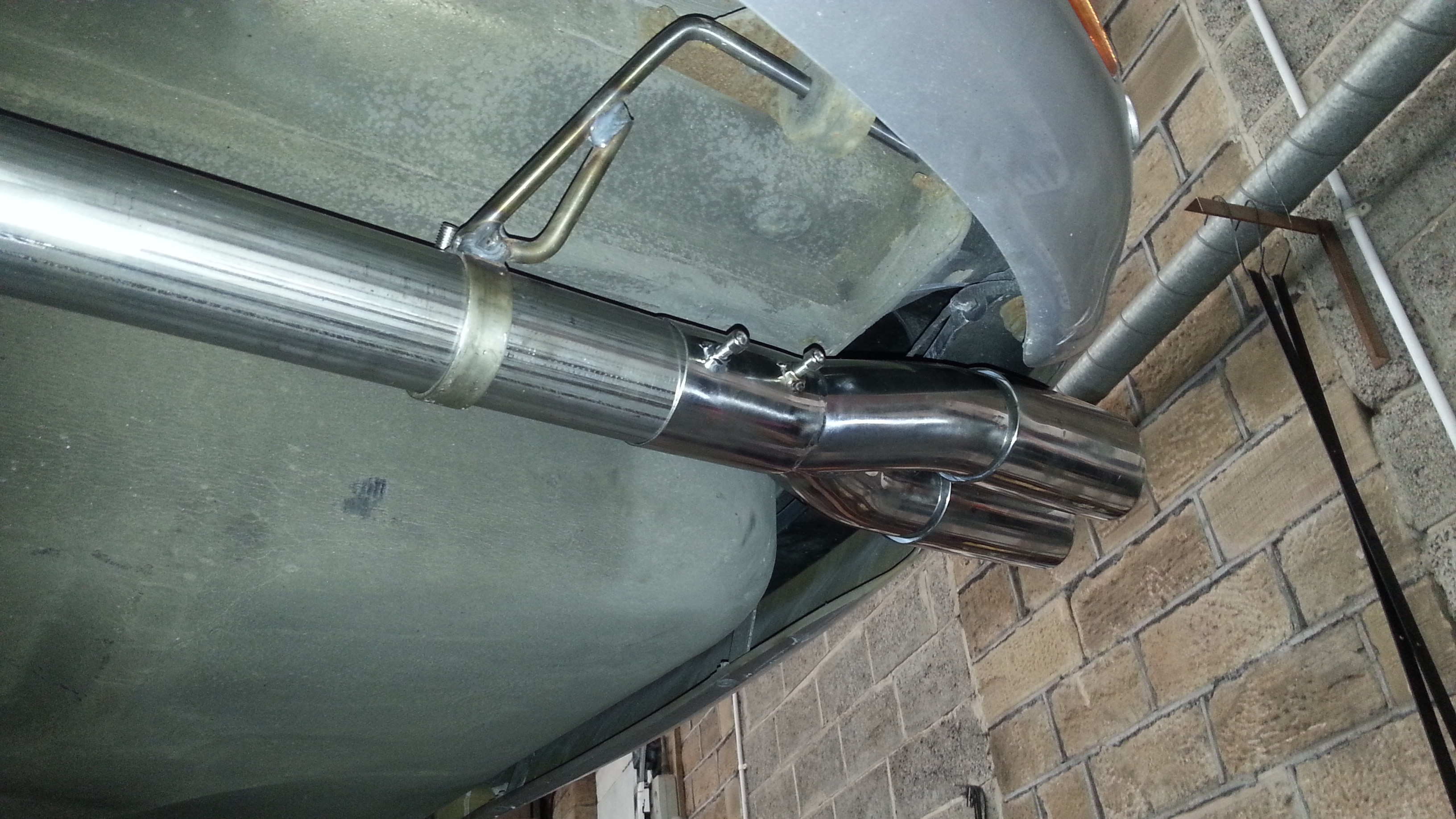

Like most here I also went with just a rear muffler delete, again like most I love the sound it makes without droning on the motorway etc.
These were purchased from adamesh (link below) and fitted by my local indy. BTW they also said they were impressed with how easy they went on. No rebending needed!
jaguar xk8 and xkr sports exhaust | performance part
