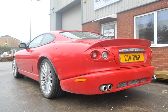

The hood that they make fits our XKR Jaguars. It has a higher rise in the middle. There is a vent at the rear near the base of the windshield. It is a subtle looking hood, but the rise is still noticable at about 2" extra in height. It has the openings for the factory XKR hood cooling vents. They say that it provides extra cooling (may or may not be true, I haven't seen a test that verifies). It is expensive and costs around $4,000 USD. I believe that it is made in England or Germany.
They also make a trunk spoiler that looks very much like the one in the photo below. I believe that they do not make the rear bumper in the photo. I believe that they only offer the custom hood and trunk spoiler as their sole exterior modification products.

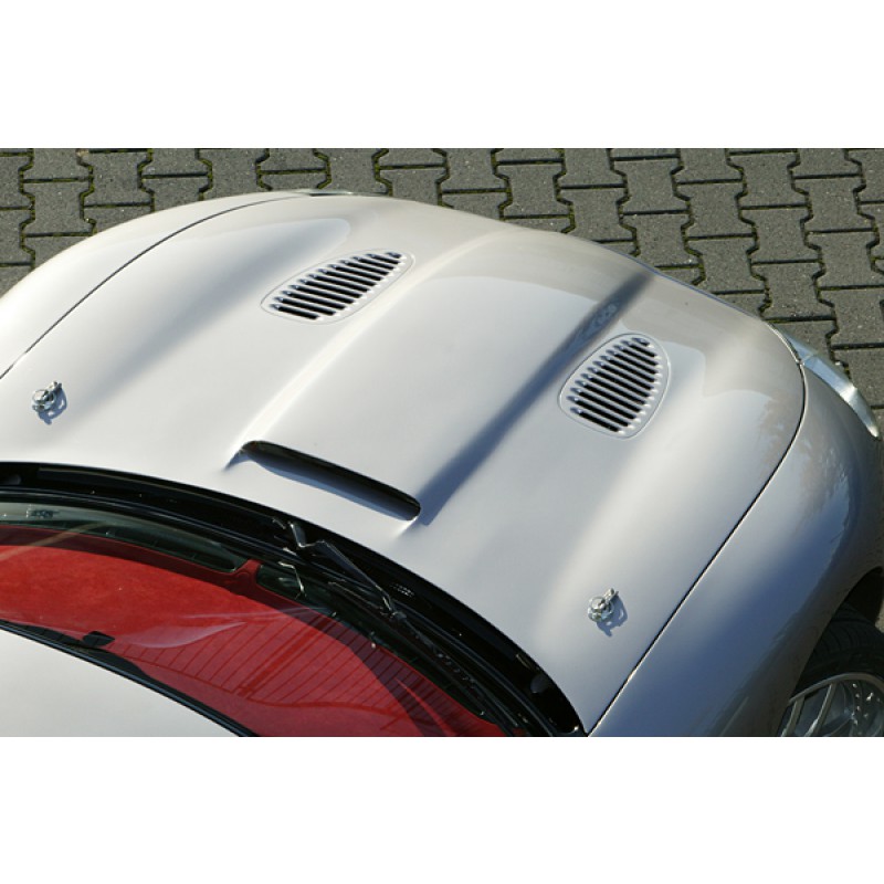

This one?
Can't see why it would have to be fitted by them in-house, surely must be possible to just ship a finished bonnet to you.

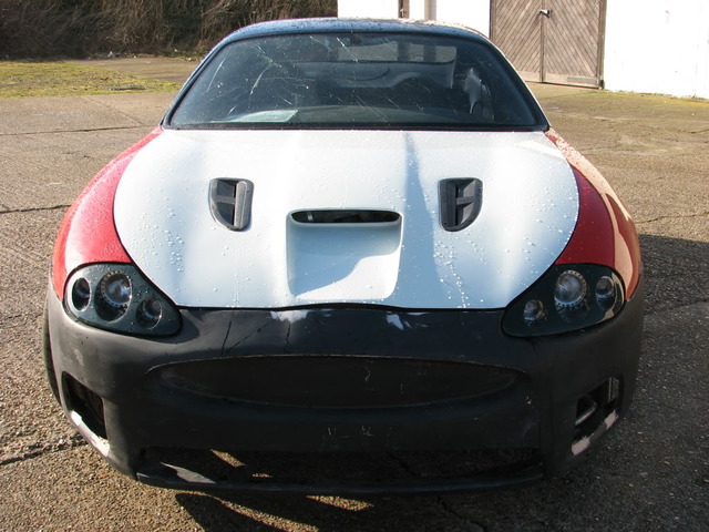

I have also done something similar to my track car, that was done for a purpose rather than bullshit. Not that I am saying the Arden hood is but like Avos has said, high pressure area coming off the screen, this is why you have ram air intakes there. So where does the air go? it may even cause lift at speed.... Possibly
I can reproduce this hood easy but a lot more modifications are needed, at least you can fit the new portfolio hood vents if you wish

Actually, it resembles an old production class rallycar trick where body modifications are not allowed ... but sloppy panel alignment is legal. It results in added downforce or at least reduced lift.

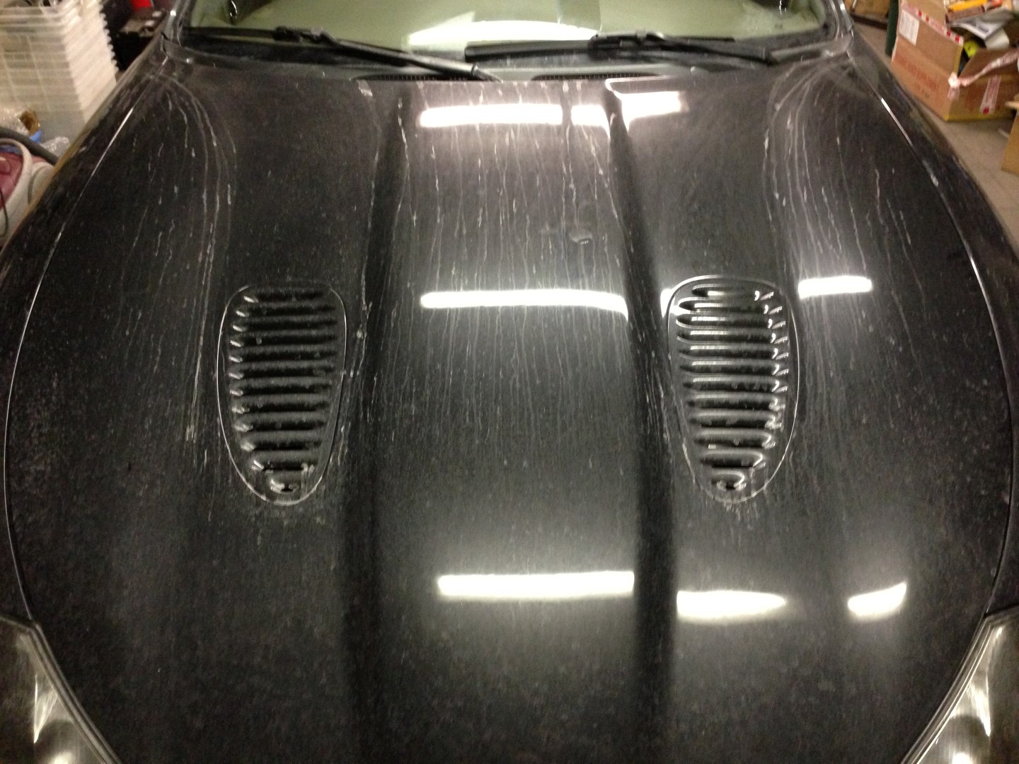

Here is a picture of my hood with salt accumulation from highway driving.
It sort of proves 3 points, 1) air is coming out of the vents, and 2) you can see the high pressure build up in the middle as is pushed outwards, and 3) I need to wash my car more often.

That pic of AVos' dirty hood is perfect! I love shots like those. When I develop aerodynamic shells for human powered racing vehicles, I've intentionally gotten them dirty so that the lines will show up, yielding evidence of the aerodynamic effects without having to rent a wind tunnel. Hah!

It is interesting to see in the dirt/rain/salt photo that AVos has provided that the air delaminates from the front of the hood's boundary layer at approximately 3" past the front of the hood's dual cooling vents.
Since the windshield behind it causes a major uplift of the air, it probably wouldn't do much good to see how turbulators would affect the lengthening of the bonding of the boundary layer, maintaining greater laminar flow. It 's also possible that greater laminar flow, up front on the hood, could send more air upward at the top of the windshield, increasing overall aerodynamic drag.
I suspect that having turbulators a few inches back from the front of the windshield, on the roof of a coupe, could actually improve gas mileage and top speed by extending laminar flow at the roof line.
Alas, I have a convertible, and this is just fun conjecture.

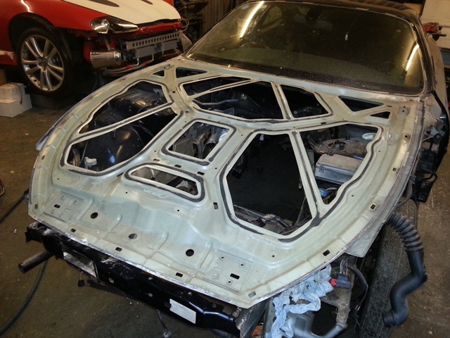

Indeed it is
It is a composite hood, all you need is a frame as below, then add the skin, lighter and you can play
Take another skin and you can see where I taped to make the cuts
Bond the 2 together, blend the edges, take a mould, start producing

Nah. I was just asking because a metal piece and hammer welding obviates risks of stress cracks typically seen on bonded on pieces.
