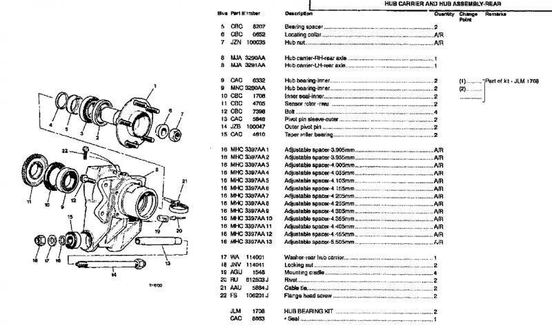

Check your hub carrier and hub assembly. We a situation of vibration and that was source. Also not sure if the photo of the assembly is for your car.
Attached Thumbnails Wicked vibration...rotors or bushings?-hub-carrier-rear.jpg
