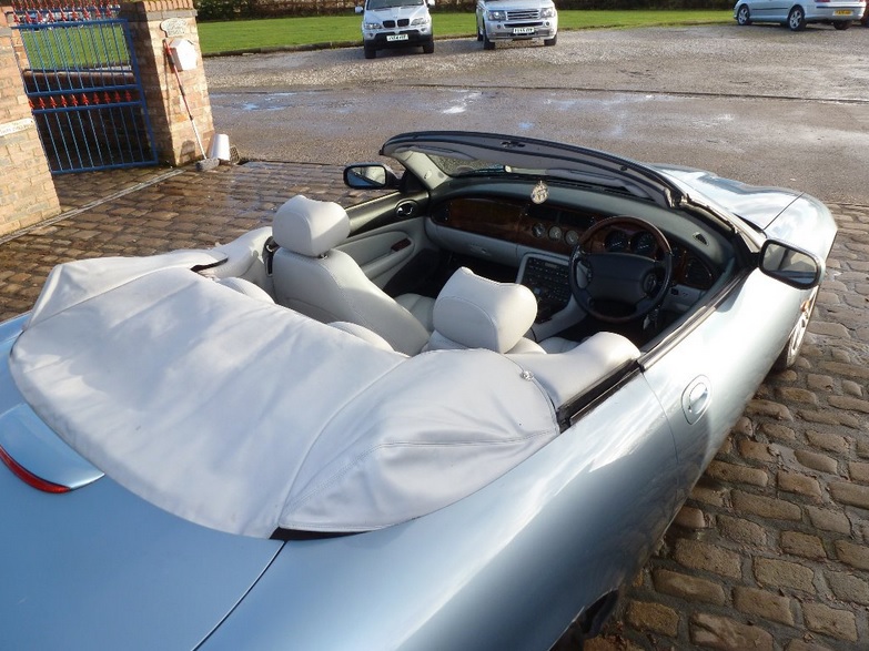

Its not the horizontal trim it the one up against the front pillar I cannot get my pics to open on this forum ? http://api.viglink.com/api/click?for...38995156951312
Old Jan 17, 2014 | 04:06 AM
Links to OnLine storage can sometimes be a problem. I've copied and posted it below.

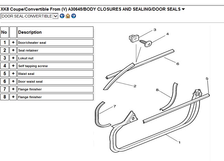

This Parts Catalogue extract could make it easier to identify the trim:
Attached Thumbnails Will the 4.2 XKR-bt_bob1.jpg   Will the 4.2 XKR-xk8-convertible.jpg

I think it must be item 2 .It shows up quite clear in the Pic. The rubber is distorted and there appears to be oxidation to the pillar under the seal. Both front and rear horizontals have been changed .
Old Jan 17, 2014 | 05:58 AM
I'd expect this Seal Retainer (item 2) to be a similar aluminium & rubber construction to the Waist Rail although, as I've always had Coupes, I haven't closely examined this part on a Convertible.
If so, the white oxide will be due to the same poor priming by the manufacturer and you should be able to refurbish it in a similar manner.

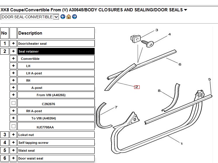

I have had another look. it is the seal on the A pillar underneath the heavy rubber one, it is held in place with 5 screws.
If you look at the photo its the seal with lumps and bumps on it,
I can not find it on ebay as I don't know its parts no or correct description

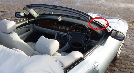

Item 2 circled in red...... ?
Here's the Parts Catalogue with the P/N's expanded:
In the UK, you could try S N G Barratt in Bridgnorth or David Manners in Oldbury.
