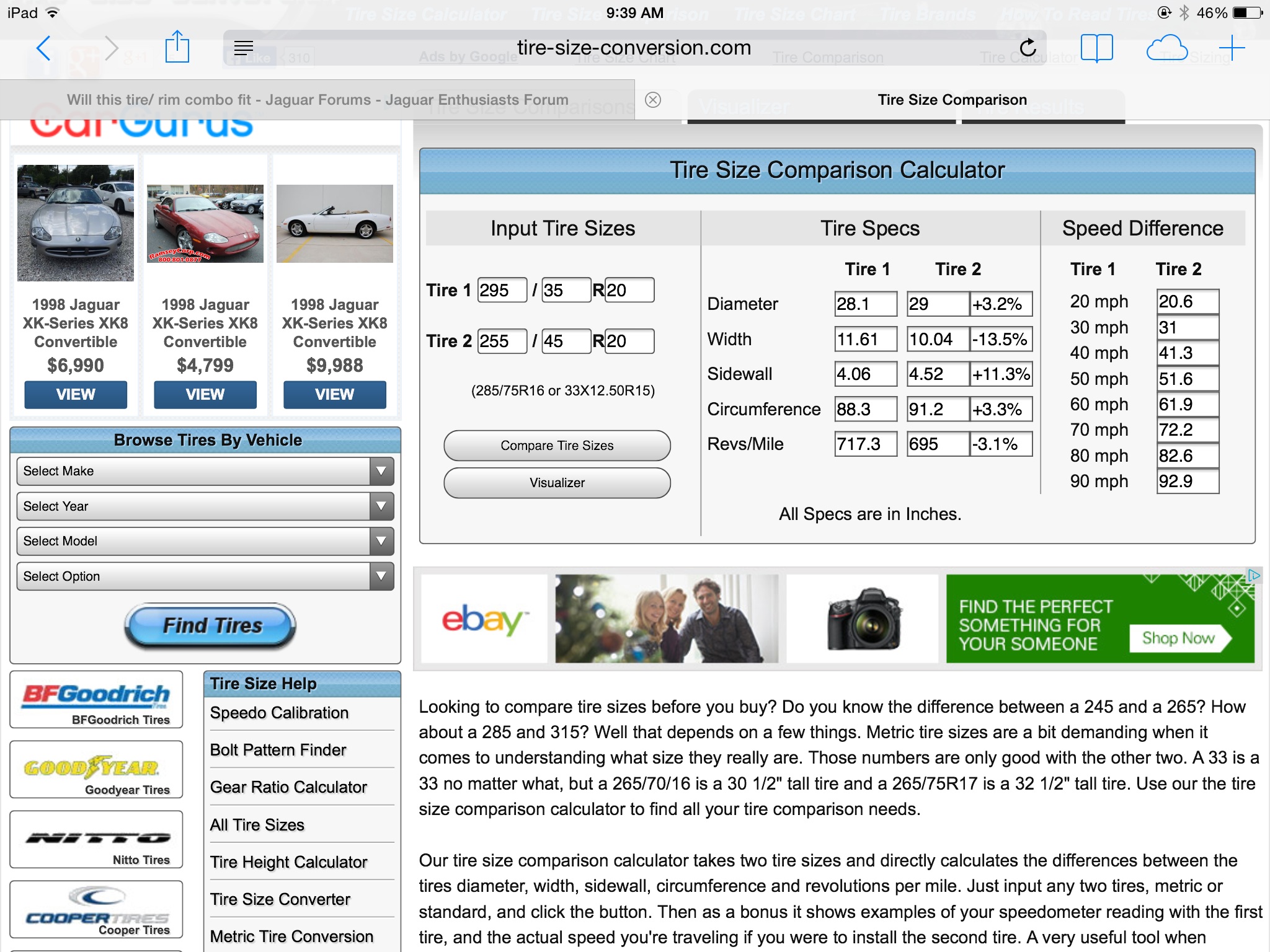

Avos, thanks for the reply. Tire/rim combos are my weak point. I can wrench and handle electrician work with no problem but the black art of tires and rims are a mystery to me.
I checked the specs on the size you listed, see attached, and the size you are running both front and rear is quite a bit more of a different/larger than my stock and the size I'm asking about.
The new set I found already have new tires installed in the size I listed so would like to use them if possible.
