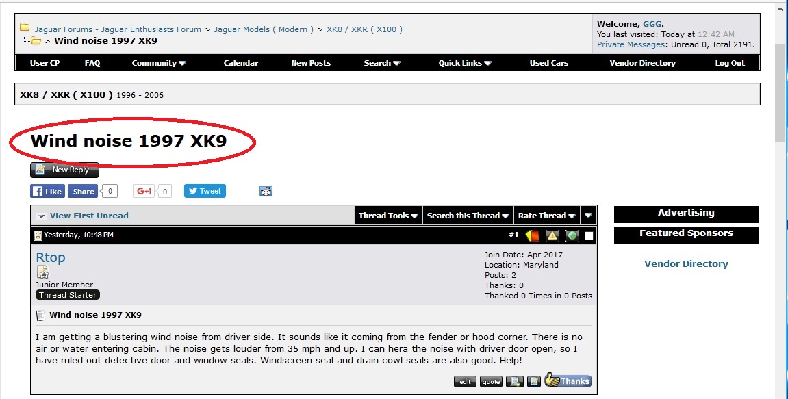

I've fixed your XK9 () and merged your two identical threads.
