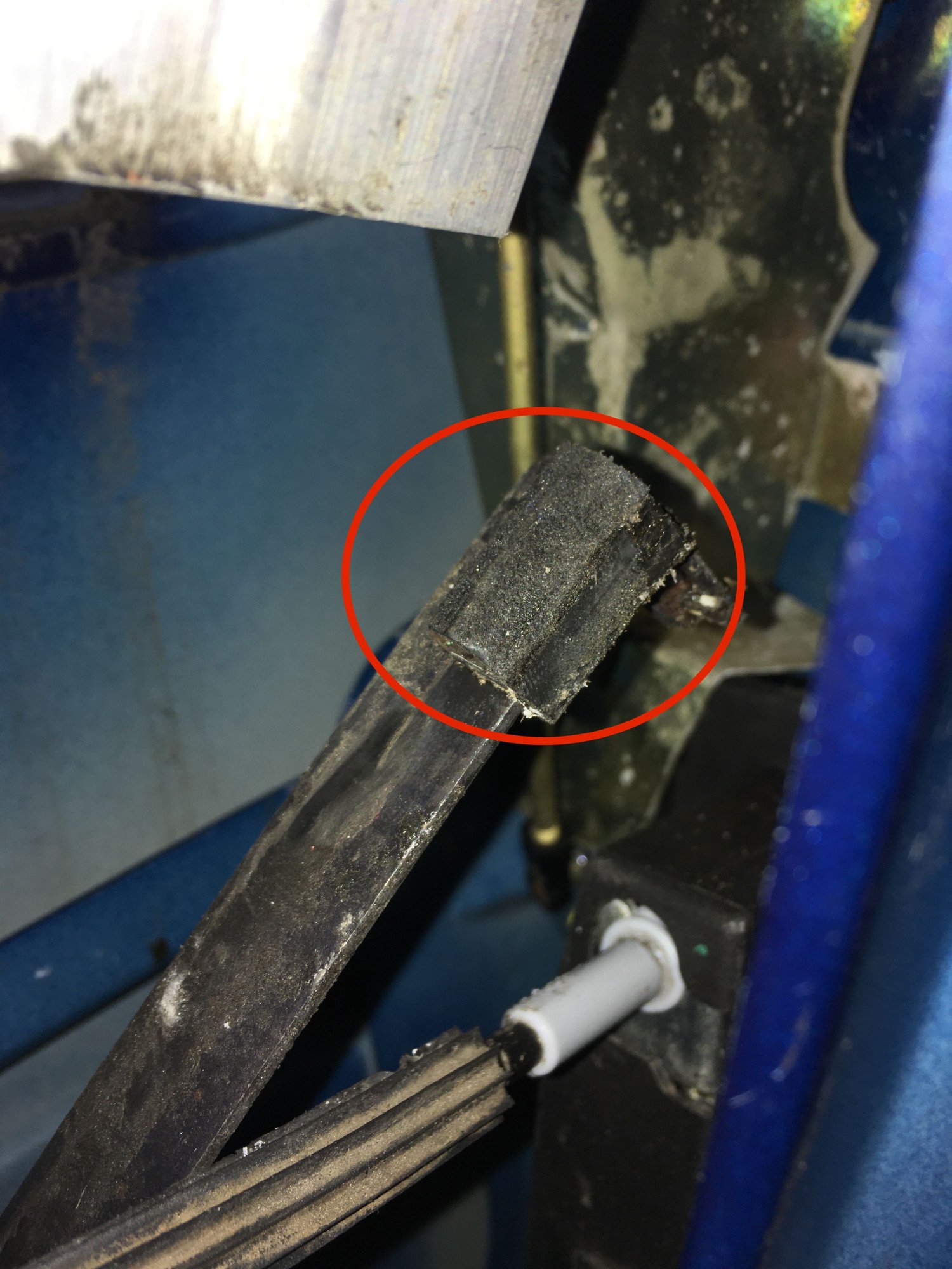

That said....Can anyone advise on how to get the window guide rail back on please? I can get it up to the top, ready for the screw to be inserted but when I try and turn it to align it for the bottom two screws to go in, it just isn't happening. When I took it out I recall twisted it slightly and It seem to "pop" apart.
I guess I amn't sure how the guide works and what it should be aligned to/with? Is it the silver block of metal** on the window that, perhaps, has a slot that then slides down the edge of this rail? Perhaps I should drop the window an inch or two for ease?

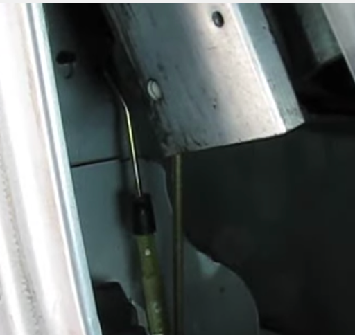

Silver window block - Does this "thread"? to the rail guide?

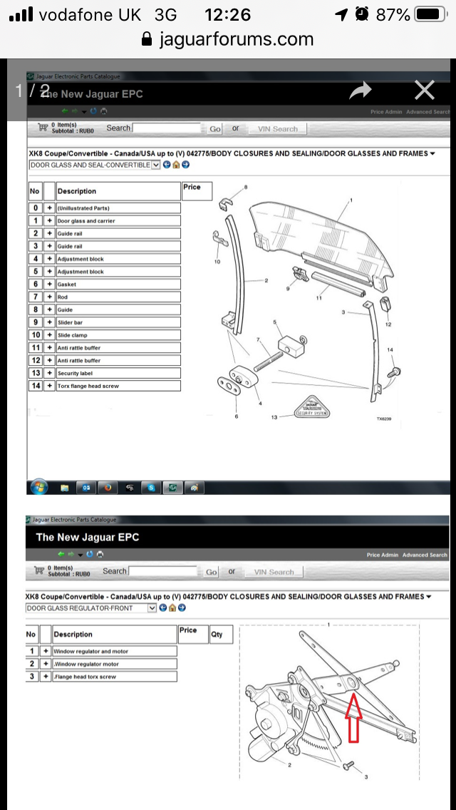

Angus, does this help?
Hey don't forget you've got the other door to use as a reference. Second time to remove the door card takes about 1=10th as long mate.
If you need more,just ask. I'm sure I've got more window docs stowed away from the 1st time I did it too.

I hadn't seen those pictures (which speak a thousand words) before - I can see the guide rail should indeed insert into the metal block on the window, so will go try and finish the job armed with what you've shown me here.

At the top of the rail guide is a rubber stopper. I hadn't even seen it (I left the rail in the door for ease) and it had slipped down an inch and thus it was stopping me getting the rail into the metal block. I slide it back to the top, dropped the window 5 mm (disconnected battery again) and then I got the guide inlace in a few minutes.

Adding this pic for completeness as it shows the Anti Rattle Buffer that was getting in my way. (Item 12 in top pic)
