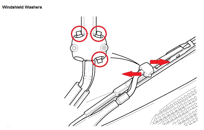

Afternoon,
Since I had my windscreen replaced in my 98 XK8 my drivers side windscreen washer jet[s?] have been squirting past the window and missing it altogether.
Any advice on how to adjust?
Old Sep 12, 2014 | 09:30 AM
The Washer 'block' can be slid along the Wiper Arm (arrowed in red) to adjust the base position.
Next, each of the neoprene 'duckbills' (circled in red) conceals a steel ball with a hole through which is the actual jet. Carefully insert a pin into these as a lever to adjust their relative positions and spray direction.
You do not want to damage the Washer 'block'. As I recall, the cost suggests it should be machined from a block of gold!

Thanks, is there a fuse I can pull to prevent the wiping of the windows while I'm doing this?

Actually, I think it's fuse number 3 next to the drivers door.

All sorted. Cheers chaps.
