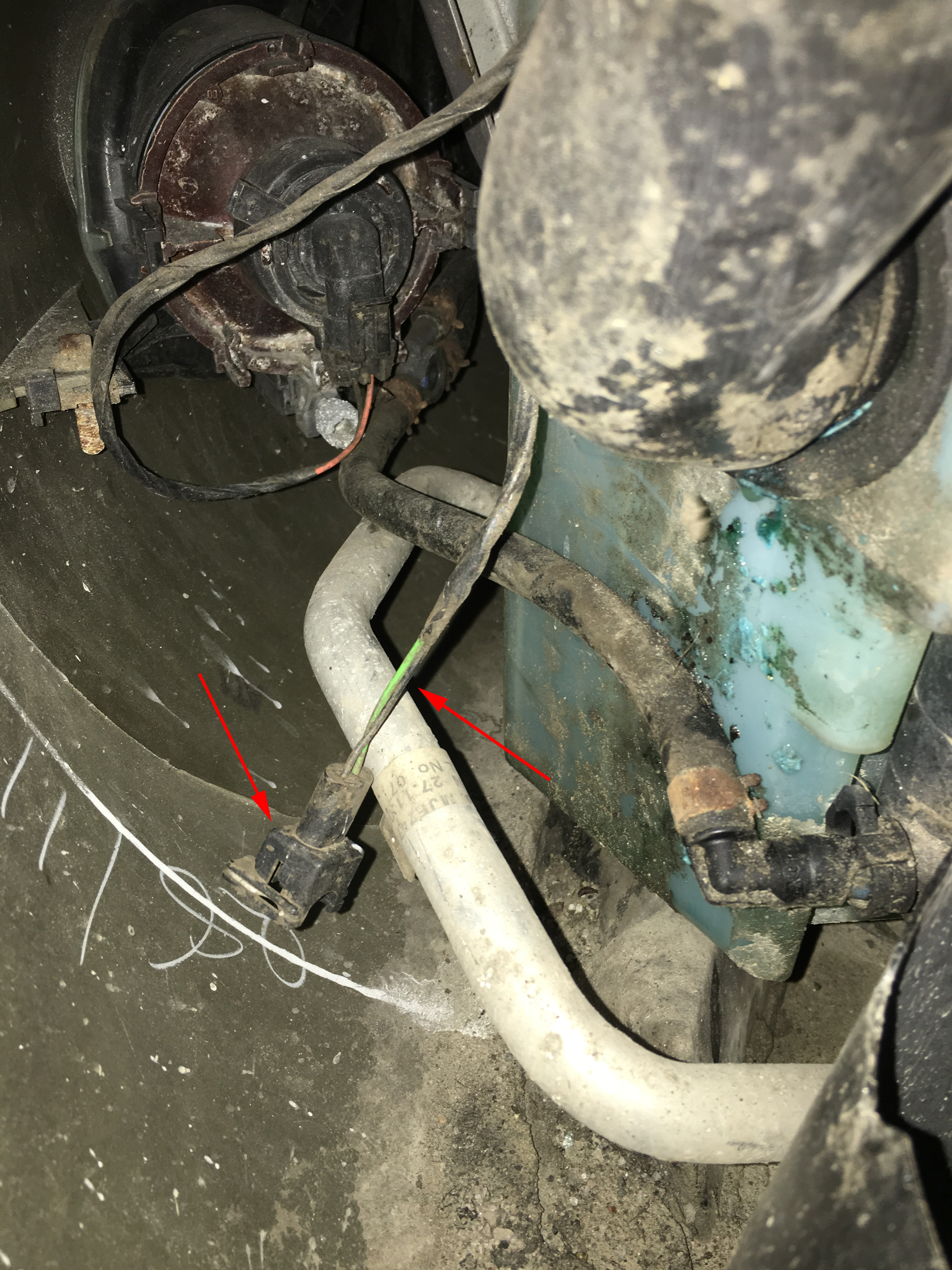

Default power wash failure - where does this cable go?
Darn this has just happened to me (2001 XKR).
Fuse is OK, relay is OK (oh and reservoir is full).
No motor sound at all so I guess a pump failure.
Any advice / walkthrough on how to replace the pump would be much appreciated
Edit:
So I've just taken of the wheel arch inspection panel to take a look at the reservoir etc.
Totally dry, no obvious leaks from tubes.
What I did find was a "spare" unconnected cable dangling down to the side of the reservoir.
There is no obvious socket for this to go into so I'm wondering whether it is spare and used for the non-powerwash versions or could it just be the reason my washers aren't working?
Anybody know what this cable is for and where it goes?

Attached Thumbnails Windscreen washer not workng on 2000 model XKR-pump-connector.jpg

I've just seen this thread https://www.jaguarforums.com/forum/x...acement-72467/
and from the photo in post 12 it seems the cable is also hanging down.
Just ordered a used reservoir and pumps for £90 off eBay. I'll get it fitted in 2 weeks when I have the MOT done.
