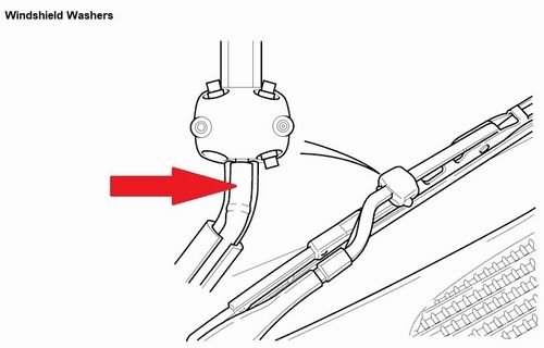

The jet nozzles are silicone "duckbills". The idea is that if the system is initially operated in freezing temperatures, the 'duckbill' nozzles flex allowing any frozen residual washer fluid to be ejected under pump pressure. The disadvantage is that silicone does get gummed up with evaporated washer fluid residue. I've successfully used an aerosol of compressed air with a straw delivery tube (sold for cleaning keyboards) to blow them clear after disconnecting the feed tube.
If they are too far gone, you are correct that the nozzle assembly is simply clipped together on the wiper arm.

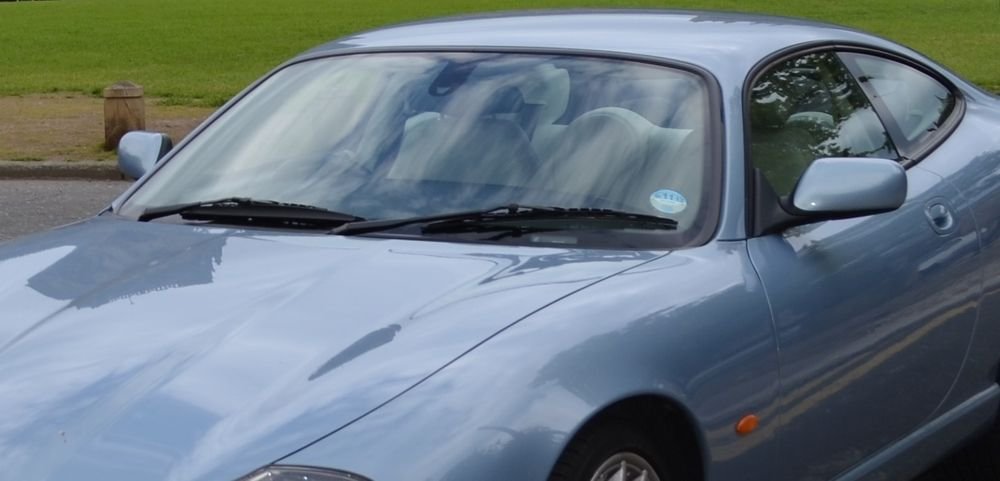

A single Air Deflector is a standard fitting and is listed in JEPC:
Here it is on my RHD 2005 XK8:
