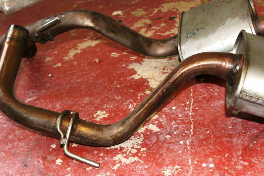

Once the original exhaust was out I could see how restrictive it is. The pipe is flattened where it starts to rise over the rear end and there is a deep dent in the middle of the flattened part. I don’t know why Jaguar did like this. The Mina is very easy to install as it travels under the rear end. It does not cut ground clearance as much as you might think. View the picture of the center bracket as this can be installed above or below its mounting point. Install it above as this pulls everything up tighter. Convertibles have 2 stabilizer bars the run from the trunk pan forward and out to behind the hubs. Mina suggests mounting the pipes tight against these. When I first mounted everything and started her up I had a rattle. Upon checking I noticed a gap between the stabilizer and the pipe. I loosened the clamps front and rear and put a jack under the low point in the pipe. You can apply considerable pressure without damaging the pipe. With the jack in place tighten the clamps. Rattle fixed. The easiest way I found to tighten the 2 side brackets

I too was shocked at the crimps over the rear axle in the stock exhaust (see the photo). The pipes are squeezed down from 2" to about 1.1" OD. And then there are those near 90 deg. bends. This cannot be good.

My parts diagram shows the intermediate stock muffler, which has the crimped pipe attached, is the same for XK8 and XKR. Front and rear stock mufflers are different parts, however.

I hope it sounds as good as the other posts indicate. I luckily have a hoist and I can see the big crimp in the factory system. Strange they would do this.
