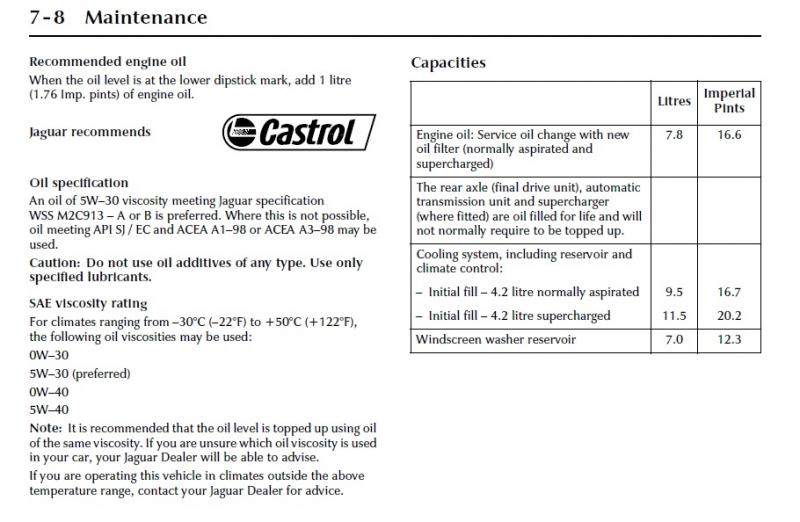

I find myself having to add washer fluid to my wife's XK8's reservoir every weekend, even when she claims that she has not activated the system even once during the previous week. I never see any washer fluid on the ground underneath the car so if the system is indeed leaking, it is doing so while the car is being driven....
My JTIS CD (which covers through the 2004 model year) indicates that the washer fluid reservoir holds 7 litres. I find that hard to believe. My Dodge Ram pickup has the largest washer fluid reservoir I've ever seen in a normal car or truck, and it doesn't come close to holding that much fluid....
Can anyone confirm that the XK8 washer fluid reservoir indeed holds 7 litres? I think that JTIS figure is a misprint....

According to the Driver's Handbook it is 7 litres capacity.

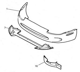

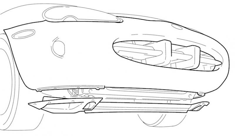

You should have a horizontal black plastic Undertray (item 7) beneath the Front Bumper (item 1). At either end of the Undertray are vertical Wind Deflectors (item 16):
Clearer to see how it fits in this diagram:
Are these missing?

I do not believe those pieces are missing. I've jacked up the front end multiple times since we purchased the car in early February and I always have to ensure that my floor jack gets past the black plastic "shield" to the firm metal crossmember underneath. I call it a shield, not an undertray, because in my opinion a true undertray covers the entire engine bay as the one on our S-Type does....
Thanks for the illustration. I will double-check the presence of this "shield" when the XK8 gets back home this afternoon....

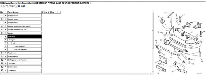

I don't expect they are missing as you would have noticed the Front Bumper flexing without them.
I always use Jaguar descriptions when mentioning parts. In this instance the Parts Manual uses the term 'Undertray' for item 7:
In reality. it's even less than a 'shield' to me - just a nasty piece of plastic!
