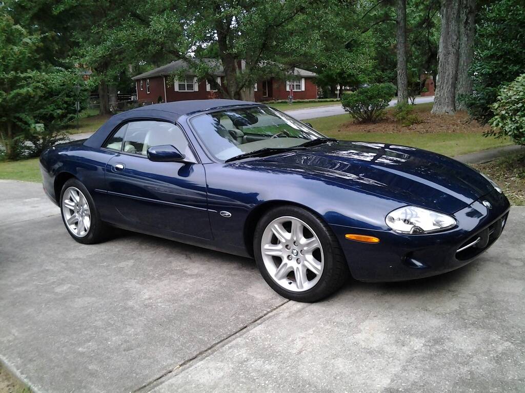

well its time to put the jag up for the winter.i've never had a car to put up for winter ,should i disconnect the battery? is there anything else i should do?
