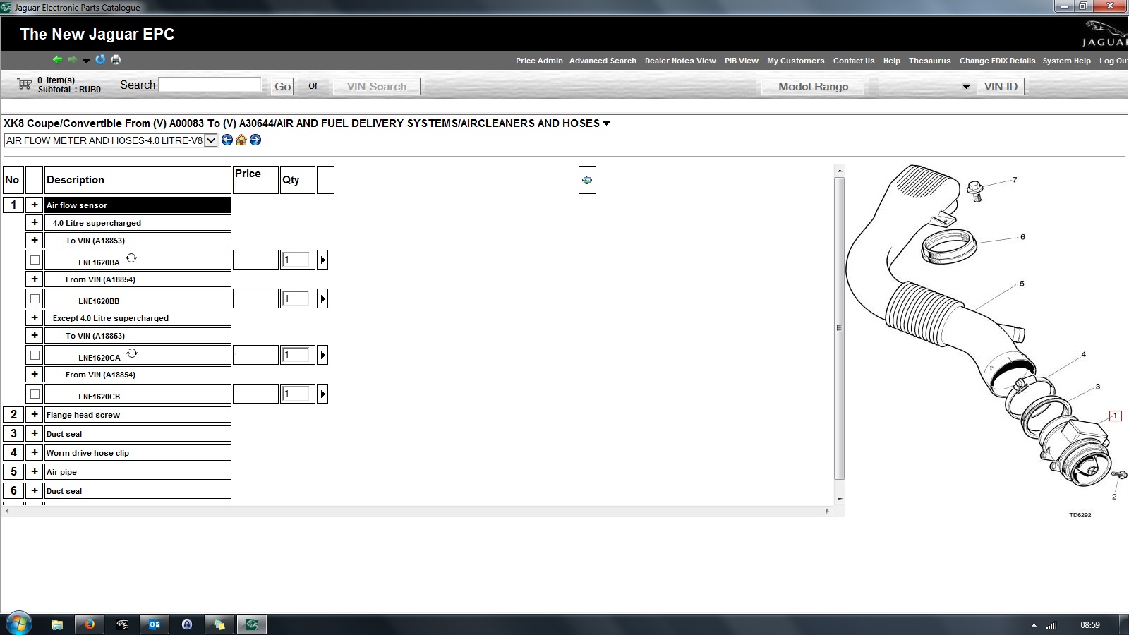

The core part Number on the Air Flow Sensor has been LNE1620 for many Model Years but the suffix changes with N/A or S/C and VIN. I think this is the right range for the VIN of your engine donor car:Originally Posted by jafari
......... So, I need a new MAS. Did the MAS change? when? and what should I be using? Please guys, I'm running out of patience as well as ideas...What about the TPS error? The TB is a refurbished one from the states bought a couple of years ago..........
The TPS is a regular issue raised on the forum. It wouldn't surprise me if a refurbished TB has got problems again after a couple of years.
